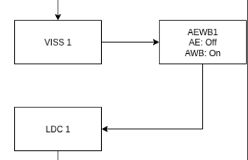

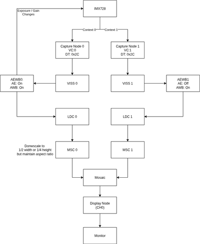

I have a custom pipeline pictured below:
EDIT: I have made a new picture that more accurately resembles the pipeline that I am testing with
I'm having trouble with the Mosaic node.  I'm building these two pipelines by hand (similar to app single cam twice).  They have the same resolution and the same bit depth.  I put the output of MSC0 and MSC1 into their own unique object arrays.  I'm configuring the mosaic node as follows:

  • I should note a couple things:
    The sensor outputs contexts interleaved, so it will stagger the frame for pipeline 1 and the frame for pipeline 2 by a few milliseconds (equal to 1/framerate).
    The sensor output is large.  It's got a native resolution of 3856 x 2176.
    I do not always get invald memtype and mem_heap_region errors, but I always get "failed to submit request".
    I've also failed to indicate what my end goal is.  I want to display text on the screen.  Unfortunately I've used both of the available image pipes on the J722S for displaying the output images, and any attempt to use a third display pipe for graphics results in failure to create the graph.  I am trying to use the mosaic node to combine the two existing outputs into one display node so I can use the other display pipe for grpahics.
  • Hi Stuart,
    How did you manage to get 2 virtual channel output form imx728 ? and also as per diagram capture_nodes are from different openvx context ?
    And what are these 2 channels giving as output, can you create single capture node ?
    Something is corrupting in the mcu2_0, we faced this issue when aewb node is there with AE:off so I asked to remove the aewb node.
    This should be fine and we have sdk demos like multi_cam, front_camera to do similar usecase. Can I get more info on the sensor and how sensor is giving you output in 2 channels.
    Also share your openvx graph's dot output to verify if the graph is created properly.
    Gokul
  • How did you manage to get 2 virtual channel output form imx728 ? and also as per diagram capture_nodes are from different openvx context ?
    With a multi-context mode, the sensor is capable of outputting different virtual channels for a given context.
    Context 0 outputs on VC0
    Context 1 outputs on VC1
    I'm creating two CSIRX nodes - so I believe I end up with 2 csirx contexts.
    I could make it one CSIRX capture node, they are both outputting at the same data rate, line count, data type, etc.  Just 2 different VCs.  The only thing that needs to be different between the graphs is exposure control, and also I need to have independent global / local tone mapping.  If you can show me how I might accomplish this I can rework my usecase :)
    See attached:

            <TR><TD bgcolor="antiquewhite">VPAC_MSC1</TD></TR>
            <TR><TD bgcolor="burlywood">DISPLAY1</TD></TR>
            </TABLE>>];
    /* List of nodes ( Pipeline = 0 )*/
    n_54 [shape=record, label="{capture_node(1)|pipe 0|desc 54}", style=filled, fillcolor=brown]
    n_58 [shape=record, label="{viss_node(1)|pipe 0|desc 58}", style=filled, fillcolor=blanchedalmond]
    n_38 [shape=record, label="{capture_node(0)|pipe 0|desc 38}", style=filled, fillcolor=brown]
    n_42 [shape=record, label="{viss_node(0)|pipe 0|desc 42}", style=filled, fillcolor=blanchedalmond]
    n_59 [shape=record, label="{mosaic_node|pipe 0|desc 59}", style=filled, fillcolor=antiquewhite]
    n_61 [shape=record, label="{display_node(0)|pipe 0|desc 61}", style=filled, fillcolor=burlywood]
    /* List of nodes ( Pipeline = 1 )*/
    n_62 [shape=record, label="{capture_node(1)|pipe 1|desc 62}", style=filled, fillcolor=brown]
    n_65 [shape=record, label="{viss_node(1)|pipe 1|desc 65}", style=filled, fillcolor=blanchedalmond]
    n_68 [shape=record, label="{capture_node(0)|pipe 1|desc 68}", style=filled, fillcolor=brown]
    n_71 [shape=record, label="{viss_node(0)|pipe 1|desc 71}", style=filled, fillcolor=blanchedalmond]
    n_74 [shape=record, label="{mosaic_node|pipe 1|desc 74}", style=filled, fillcolor=antiquewhite]
    n_77 [shape=record, label="{display_node(0)|pipe 1|desc 77}", style=filled, fillcolor=burlywood]
    /* List of nodes ( Pipeline = 2 )*/
    n_63 [shape=record, label="{capture_node(1)|pipe 2|desc 63}", style=filled, fillcolor=brown]
    n_66 [shape=record, label="{viss_node(1)|pipe 2|desc 66}", style=filled, fillcolor=blanchedalmond]
    n_69 [shape=record, label="{capture_node(0)|pipe 2|desc 69}", style=filled, fillcolor=brown]
    n_72 [shape=record, label="{viss_node(0)|pipe 2|desc 72}", style=filled, fillcolor=blanchedalmond]
    n_75 [shape=record, label="{mosaic_node|pipe 2|desc 75}", style=filled, fillcolor=antiquewhite]
    n_78 [shape=record, label="{display_node(0)|pipe 2|desc 78}", style=filled, fillcolor=burlywood]
    /* List of nodes ( Pipeline = 3 )*/
    n_64 [shape=record, label="{capture_node(1)|pipe 3|desc 64}", style=filled, fillcolor=brown]
    n_67 [shape=record, label="{viss_node(1)|pipe 3|desc 67}", style=filled, fillcolor=blanchedalmond]
    n_70 [shape=record, label="{capture_node(0)|pipe 3|desc 70}", style=filled, fillcolor=brown]
    n_73 [shape=record, label="{viss_node(0)|pipe 3|desc 73}", style=filled, fillcolor=blanchedalmond]
    n_76 [shape=record, label="{mosaic_node|pipe 3|desc 76}", style=filled, fillcolor=antiquewhite]
    n_79 [shape=record, label="{display_node(0)|pipe 3|desc 79}", style=filled, fillcolor=burlywood]
    /* Dependency of nodes within pipeline (Pipeline = 0) */
    n_54 -> n_58 [style=dashed]
    n_54 -> n_58 [style=dashed, color=gray]
    n_58 -> n_59 [style=dashed]
    n_38 -> n_42 [style=dashed]
    n_38 -> n_42 [style=dashed, color=gray]
    n_42 -> n_59 [style=dashed]
    n_42 -> n_59 [style=dashed, color=gray]
    n_58 -> n_59 [style=dashed, color=gray]
    n_59 -> n_61 [style=dashed]
    n_59 -> n_61 [style=dashed, color=gray]
    /* Dependency of nodes within pipeline (Pipeline = 1) */
    n_62 -> n_65 [style=dashed]
    n_62 -> n_65 [style=dashed, color=gray]
    n_65 -> n_74 [style=dashed]
    n_68 -> n_71 [style=dashed]
    n_68 -> n_71 [style=dashed, color=gray]
    n_71 -> n_74 [style=dashed]
    n_71 -> n_74 [style=dashed, color=gray]
    n_65 -> n_74 [style=dashed, color=gray]
    n_74 -> n_77 [style=dashed]
    n_74 -> n_77 [style=dashed, color=gray]
    /* Dependency of nodes within pipeline (Pipeline = 2) */
    n_63 -> n_66 [style=dashed]
    n_63 -> n_66 [style=dashed, color=gray]
    n_66 -> n_75 [style=dashed]
    n_69 -> n_72 [style=dashed]
    n_69 -> n_72 [style=dashed, color=gray]
    n_72 -> n_75 [style=dashed]
    n_72 -> n_75 [style=dashed, color=gray]
    n_66 -> n_75 [style=dashed, color=gray]
    n_75 -> n_78 [style=dashed]
    n_75 -> n_78 [style=dashed, color=gray]
    /* Dependency of nodes within pipeline (Pipeline = 3) */
    n_64 -> n_67 [style=dashed]
    n_64 -> n_67 [style=dashed, color=gray]
    n_67 -> n_76 [style=dashed]
    n_70 -> n_73 [style=dashed]
    n_70 -> n_73 [style=dashed, color=gray]
    n_73 -> n_76 [style=dashed]
    n_73 -> n_76 [style=dashed, color=gray]
    n_67 -> n_76 [style=dashed, color=gray]
    n_76 -> n_79 [style=dashed]
    n_76 -> n_79 [style=dashed, color=gray]
    ln_54 [shape=record, label="{capture_node(1)|pipe 0|desc 54}", style=filled, fillcolor=brown]
    ln_58 [shape=record, label="{viss_node(1)|pipe 0|desc 58}", style=filled, fillcolor=blanchedalmond]
    ln_38 [shape=record, label="{capture_node(0)|pipe 0|desc 38}", style=filled, fillcolor=brown]
    ln_42 [shape=record, label="{viss_node(0)|pipe 0|desc 42}", style=filled, fillcolor=blanchedalmond]
    ln_59 [shape=record, label="{mosaic_node|pipe 0|desc 59}", style=filled, fillcolor=antiquewhite]
    ln_61 [shape=record, label="{display_node(0)|pipe 0|desc 61}", style=filled, fillcolor=burlywood]
    ln_62 [shape=record, label="{capture_node(1)|pipe 1|desc 62}", style=filled, fillcolor=brown]
    ln_65 [shape=record, label="{viss_node(1)|pipe 1|desc 65}", style=filled, fillcolor=blanchedalmond]
    ln_68 [shape=record, label="{capture_node(0)|pipe 1|desc 68}", style=filled, fillcolor=brown]
    ln_71 [shape=record, label="{viss_node(0)|pipe 1|desc 71}", style=filled, fillcolor=blanchedalmond]
    ln_74 [shape=record, label="{mosaic_node|pipe 1|desc 74}", style=filled, fillcolor=antiquewhite]
    ln_77 [shape=record, label="{display_node(0)|pipe 1|desc 77}", style=filled, fillcolor=burlywood]
    ln_63 [shape=record, label="{capture_node(1)|pipe 2|desc 63}", style=filled, fillcolor=brown]
    ln_66 [shape=record, label="{viss_node(1)|pipe 2|desc 66}", style=filled, fillcolor=blanchedalmond]
    ln_69 [shape=record, label="{capture_node(0)|pipe 2|desc 69}", style=filled, fillcolor=brown]
    ln_72 [shape=record, label="{viss_node(0)|pipe 2|desc 72}", style=filled, fillcolor=blanchedalmond]
    ln_75 [shape=record, label="{mosaic_node|pipe 2|desc 75}", style=filled, fillcolor=antiquewhite]
    ln_78 [shape=record, label="{display_node(0)|pipe 2|desc 78}", style=filled, fillcolor=burlywood]
    ln_64 [shape=record, label="{capture_node(1)|pipe 3|desc 64}", style=filled, fillcolor=brown]
    ln_67 [shape=record, label="{viss_node(1)|pipe 3|desc 67}", style=filled, fillcolor=blanchedalmond]
    ln_70 [shape=record, label="{capture_node(0)|pipe 3|desc 70}", style=filled, fillcolor=brown]
    ln_73 [shape=record, label="{viss_node(0)|pipe 3|desc 73}", style=filled, fillcolor=blanchedalmond]
    ln_76 [shape=record, label="{mosaic_node|pipe 3|desc 76}", style=filled, fillcolor=antiquewhite]
    ln_79 [shape=record, label="{display_node(0)|pipe 3|desc 79}", style=filled, fillcolor=burlywood]
    /* Dependency of nodes across pipeline ( Pipeline = 0 ) */
    ln_64 -> ln_54 [style=dashed]
    ln_67 -> ln_58 [style=dashed]
    ln_70 -> ln_38 [style=dashed]
    ln_73 -> ln_42 [style=dashed]
    ln_76 -> ln_59 [style=dashed]
    ln_79 -> ln_61 [style=dashed]
    /* Dependency of nodes across pipeline ( Pipeline = 1 ) */
    ln_54 -> ln_62 [style=dashed]
    ln_58 -> ln_65 [style=dashed]
    ln_38 -> ln_68 [style=dashed]
    ln_42 -> ln_71 [style=dashed]
    ln_59 -> ln_74 [style=dashed]
    ln_61 -> ln_77 [style=dashed]
    /* Dependency of nodes across pipeline ( Pipeline = 2 ) */
    ln_62 -> ln_63 [style=dashed]
    ln_65 -> ln_66 [style=dashed]
    ln_68 -> ln_69 [style=dashed]
    ln_71 -> ln_72 [style=dashed]
    ln_74 -> ln_75 [style=dashed]
    ln_77 -> ln_78 [style=dashed]
    /* Dependency of nodes across pipeline ( Pipeline = 3 ) */
    ln_63 -> ln_64 [style=dashed]
    ln_66 -> ln_67 [style=dashed]
    ln_69 -> ln_70 [style=dashed]
    ln_72 -> ln_73 [style=dashed]
    ln_75 -> ln_76 [style=dashed]
    ln_78 -> ln_79 [style=dashed]
    /* List of Data References */
    d_53 [shape=record , label="{user_data_object_122   | size 216 | desc 53}"]
    d_45 [shape=record , label="{cap_buf_in[3](1)    | desc 45}"]
    d_55 [shape=record , label="{viss_cfg(1)   | size 112 | desc 55}"]
    d_57 [shape=record , label="{user_data_object_125   | size 41995 | desc 57}"]
    d_26 [shape=record , label="{viss_img_out(1)  | [in] mosaic_in(1) | size 12585984 | desc 26}"]
    d_25 [shape=record , label="{mosaic_in(1)    | desc 25}"]
    d_56 [shape=record , label="{user_data_object_124   | size 24640 | desc 56}"]
    d_37 [shape=record , label="{user_data_object_107   | size 216 | desc 37}"]
    d_29 [shape=record , label="{cap_buf_in[3](0)    | desc 29}"]
    d_39 [shape=record , label="{viss_cfg(0)   | size 112 | desc 39}"]
    d_41 [shape=record , label="{user_data_object_110   | size 41995 | desc 41}"]
    d_24 [shape=record , label="{viss_img_out(0)  | [in] display_params(0) | size 12585984 | desc 24}"]
    d_23 [shape=record , label="{display_params(0)    | desc 23}"]
    d_40 [shape=record , label="{user_data_object_109   | size 24640 | desc 40}"]
    d_17 [shape=record , label="{mosaic_node_config   | size 1424 | desc 17}"]
    d_18 [shape=record , label="{mosaic_img_out   | size 3110400 | desc 18}"]
    d_60 [shape=record , label="{user_data_object_128   | size 44 | desc 60}"]
    d_data_ref_q_171 [shape=record, style=filled , fillcolor=yellow, label="{data_ref_q_171|bufs 4}"]
    d_29 -> d_data_ref_q_171
    d_30 [shape=record , label="{cap_raw_in(0)  | [in] cap_buf_in[3](0) | size 16873856 | desc 30}"]
    d_30 -> d_29 [style=dashed]
    d_31 [shape=record , label="{object_array_101    | desc 31}"]
    d_31 -> d_data_ref_q_171
    d_32 [shape=record , label="{raw_image_102  | [in] object_array_101 | size 16873856 | desc 32}"]
    d_32 -> d_31 [style=dashed]
    d_33 [shape=record , label="{object_array_103    | desc 33}"]
    d_33 -> d_data_ref_q_171
    d_34 [shape=record , label="{raw_image_104  | [in] object_array_103 | size 16873856 | desc 34}"]
    d_34 -> d_33 [style=dashed]
    d_35 [shape=record , label="{object_array_105    | desc 35}"]
    d_35 -> d_data_ref_q_171
    d_36 [shape=record , label="{raw_image_106  | [in] object_array_105 | size 16873856 | desc 36}"]
    d_36 -> d_35 [style=dashed]
    d_data_ref_q_172 [shape=record, style=filled , fillcolor=yellow, label="{data_ref_q_172|bufs 4}"]
    d_45 -> d_data_ref_q_172
    d_46 [shape=record , label="{cap_raw_in(1)  | [in] cap_buf_in[3](1) | size 16873856 | desc 46}"]
    d_46 -> d_45 [style=dashed]
    d_47 [shape=record , label="{object_array_116    | desc 47}"]
    d_47 -> d_data_ref_q_172
    d_48 [shape=record , label="{raw_image_117  | [in] object_array_116 | size 16873856 | desc 48}"]
    d_48 -> d_47 [style=dashed]
    d_49 [shape=record , label="{object_array_118    | desc 49}"]
    d_49 -> d_data_ref_q_172
    d_50 [shape=record , label="{raw_image_119  | [in] object_array_118 | size 16873856 | desc 50}"]
    d_50 -> d_49 [style=dashed]
    d_51 [shape=record , label="{object_array_120    | desc 51}"]
    d_51 -> d_data_ref_q_172
    d_52 [shape=record , label="{raw_image_121  | [in] object_array_120 | size 16873856 | desc 52}"]
    d_52 -> d_51 [style=dashed]
    d_data_ref_q_173 [shape=record, style=filled , fillcolor=lightgrey, label="{data_ref_q_173|bufs 4}"]
    d_25 -> d_data_ref_q_173
    d_26 -> d_25 [style=dashed]
    d_80 [shape=record , label="{image_162   | size 12585984 | desc 80}"]
    d_80 -> d_data_ref_q_173
    d_81 [shape=record , label="{image_163   | size 12585984 | desc 81}"]
    d_81 -> d_data_ref_q_173
    d_82 [shape=record , label="{image_164   | size 12585984 | desc 82}"]
    d_82 -> d_data_ref_q_173
    d_data_ref_q_174 [shape=record, style=filled , fillcolor=lightgrey, label="{data_ref_q_174|bufs 4}"]
    d_23 -> d_data_ref_q_174
    d_24 -> d_23 [style=dashed]
    d_83 [shape=record , label="{image_165   | size 12585984 | desc 83}"]
    d_83 -> d_data_ref_q_174
    d_84 [shape=record , label="{image_166   | size 12585984 | desc 84}"]
    d_84 -> d_data_ref_q_174
    d_85 [shape=record , label="{image_167   | size 12585984 | desc 85}"]
    d_85 -> d_data_ref_q_174
    d_data_ref_q_175 [shape=record, style=filled , fillcolor=lightgrey, label="{data_ref_q_175|bufs 4}"]
    d_18 -> d_data_ref_q_175
    d_86 [shape=record , label="{image_168   | size 3110400 | desc 86}"]
    d_86 -> d_data_ref_q_175
    d_87 [shape=record , label="{image_169   | size 3110400 | desc 87}"]
    d_87 -> d_data_ref_q_175
    d_88 [shape=record , label="{image_170   | size 3110400 | desc 88}"]
    d_88 -> d_data_ref_q_175
    /* List of data reference queues */
    d_113 [shape=record, style=filled , fillcolor=yellow, label="{data_ref_q_171|bufs 4|pipe 0|in_nodes 1|desc 113 }"]
    d_115 [shape=record, style=filled , fillcolor=yellow, label="{data_ref_q_171|bufs 4|pipe 1|in_nodes 1|desc 115 }"]

  • Hi Stuart,
    Sorry for the late reply, because of festival holidays last week.
    Okay, should be fine I was confused with openvx context.
    You can use same csirx node for both virtual channels, and configure different dcc configs for each viss nodes (replicated), direct examples are not there,
    you can refer to multicam_demo for using single csirx to capture 2 channels of data,
    for viss_node create you have to do some changes,
    since the viss_node is replicated for 2 channels coming from csirx you have to create an object_array for both parameter 0 and 2 ( configuration and dcc_buf)
    each element of the object_array corresponds to the camera channel and populate the data accordingly.
    and make the replicate flag to be true for both 0 and 2nd parameter
    Coming back to the graph output you shared, buffers from viss node to mosaic node is not created properly,
    the output of viss_node is an image and input for mosaic node is an object_array, here in your graph only one buffer is created properly and the other 3 buffers are not.
    set the replicate flag for the viss_output_arr, this will create the buffers properly.
    I hope you are updating obj-<mosaicObj.num_inputs = 2;  in your code
    can you share the snippet of viss_node creation part and the buffers creation part for viss_output_arr
    Gokul
  • Gokul - thank you for your reply.  I have a lot of questions.
    It does look like using replicate will fix my issues - but I'd appreciate if you answer my questions so I can learn what's going on.
    0: Yes, I'm using mosaicObj.num_inputs = 2.  I've refactored the code a fair bit, see #4
    1: How do I get a visual output of the dot graph?  That looks really handy.  :)
    2: What is replicating doing in this example?
    Inside of multi-cam, it connects the output of the VISS node by using "vxGetObjectArrayItem" and pulling out the first image in the array.  Then it uses that same array reference to pass the input to the mosaic node.
    It looks like what's happening is that by duplicating the VISS node, it's able to write to subsequent indices inside of that object array output, which can then seamlessly be passed into the mosaicing node.
    How come I can't reproduce the same behavior by just using vxGetObjectArrayItem() for both VISS nodes?
    3: If I replicate, I may need different VISS DCC buffers, but most importantly, I'd need different AEWB behavior.
    Ideally, I want AEWB on context 0, and only AWB on context 1.  I assume I can do this the same way via replication.
    4: I refactored a lot of code.  VISS code looks like app single cam mostly.  See details below

  • Hi Stuart,
    You can refer to this page https://software-dl.ti.com/jacinto7/esd/processor-sdk-rtos-jacinto7/latest/exports/docs/tiovx/docs/user_guide/JPEG_TOOL.html
    or use the online tool https://dreampuf.github.io/GraphvizOnline
    There is a known issue when two nodes are connected where one node give output as image and the following node takes object array as input the buffers are not created correctly by the framework. Making it as replicated will check if the image has any parent object which is the obj_arr and hence will allocate buffers for the obj_array instead of image.
    in multi_cam demo by default it is replicated so there it works fine, as explained earlier making it as replicated even though you have single instance of node is required to solve this issue.
    Yes, making the dcc buffer as a part of object_arr you can provide different buffers to different viss_node operating on channel 0 and channel 1.
    Read more on the replicate in the docs
    Is the issue related to this "tixSetNodeParameterNumBufByIndex" function - like here:
    I don't this there is any issues in here, your graph output will tell the number of buffers created for each outputs of node this way we can verify if the api is working or not. In your graph's dot output all the outputs have buffer depth of 4, the problem is among 4 (1-obj_arr, 3-image).
    Can you try these changes with aewb node disabled and check if the pipeline is working fine.
    Gokul
  • Hi Gokul,
    I moved everything over to a app_multi_cam style pipeline, and it mosaicing worked fine with my dual context camera.  Thank you.
    I have a follow up question, because I'm going to run into this problem again.  Suppose I have the same situation - single sensor multiple contexts, but this time one of the contexts has a different resolution.  Will it be possible to display both of those images onto the screen as well as have graphics? Is there a 3rd display pipeline available on the TDA4VEN that works differently? Or is there a way to make mosaicing work with two images of different resolutions?
    Thank you again!
  • Hi Stuart,
    There are only 2 pipelines available per instance in tda4ven so you have to use mosaic node to combine 2 images.
    Mosaic can take images with different resolutions as it internally uses MSC to downscale the image to fit within the window and the internal scaler is configured as per the input image dimensions and window dimensions .
    But you might have to split the images into two different obj_arrays and give it as two different input to mosaic node.
    Gokul
  • Gokul - thank you.  That is what I was trying to do originally and failed.  I think the mistake I made is that I will need 2 different arrays of obj_array, since it needs 2 dimensions of images: one from the different captures, one for the pipeline buffering.  Is this right?
    Thank you again for all your help.
