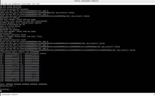

    When I execute the above commands, everything works fine without using saveenv. However, if I run saveenv after these commands, the boot process fails and throws the errors below.
    ** No partition table - mmc 0 **
    Couldn't find partition mmc 0:2
    Can't set block device
    [wtx debug] fs/fs.c:do_load() line 766: argc=5; arg[0]: load
    [wtx debug] fs/fs.c:do_load() line 766: argc=5; arg[1]: mmc
    [wtx debug] fs/fs.c:do_load() line 766: argc=5; arg[2]: 0:2
    [wtx debug] fs/fs.c:do_load() line 766: argc=5; arg[3]: 0x82000000
    [wtx debug] fs/fs.c:do_load() line 766: argc=5; arg[4]: /boot/Image
    [wtx debug] fs/fs.c:do_load() line 766: argc=5; arg[3]: 0x88000000
    [wtx debug] fs/fs.c:do_load() line 766: argc=5; arg[4]: /boot/dtb/ti/k3-j784s4-wtxAquila_v3.dtb
    libfdt fdt_check_header(): FDT_ERR_BADMAGIC
    No FDT memory address configured. Please configure
    the FDT address via "fdt addr <address>" command.
    Aborting!
    Bad Linux ARM64 Image magic!
    switch to partitions #0, OK
    mmc0(part 0) is current device
    Couldn't find partition mmc 0:1
    MMC: no card present
    mmc_init: -123, time 2002
    starting USB...
    No working controllers found
    USB is stopped. Please issue 'usb start' first.
    starting USB...
    Could not get PHY for ethernet@46000000port@1: addr 0
    am65_cpsw_nuss_port ethernet@46000000ethernet@46000000port@1: phy_connect() failed
    am65_cpsw_nuss_port ethernet@46000000ethernet@46000000ethernet@46000000port@1: phy_connect() failed
    am65_cpsw_nuss_port ethernet@46000000ethernet@46000000ethernet@46000000ethernet@46000000port@1: phy_connect() failed
    am65_cpsw_nuss_port ethernet@46000000ethernet@46000000ethernet@46000000ethernet@46000000ethernet@46000000port@1: phy_connect() failed
    am65_cpsw_nuss_port ethernet@46000000ethernet@46000000ethernet@46000000ethernet@46000000ethernet@46000000ethernet@46000000port@1: phy_connect() failed
    "Synchronous Abort" handler, esr 0x8a000000
    elr: ffffffffb1d40472 lr : ffffffffb1d40472 (reloc)
    elr: 0000000031407472 lr : 0000000031407472
    x0 : 00000000ffffffed x1 : 0000000000000000
    x2 : 0000000000000002 x3 : 00000000fde97f60
    x4 : 00000000fffbfd50 x5 : 00000000fde97f80
    x6 : 0000000000000021 x7 : 00000000fdedc0e0
    x8 : 00000000fde72df0 x9 : 0000000000000008
    x10: 00000000ffffffd8 x11: 000000000000000a
    x12: 0000000000002d18 x13: 00000000fde71ee8
    x14: 00000000fde72df0 x15: 0000000000000002
    x16: 00000000fff2fe0c x17: 0000000000000000
    x18: 00000000fde86db0 x19: 00000000fde93a10
    x20: 00000000fde93a30 x21: 00000000fffef000
    x22: 0000000000000004 x23: 00000000fffed000
    x24: 0000000000000000 x25: 00000000fffef000
    x26: 00000000fffed000 x27: 0000000000000000
    x28: 00000000fde96930 x29: 6f70303030303030
    Code: 00000000 00000000 00000000 00000000 (00000000)
    Resetting CPU ...
    resetting ...
    Without saveenv → System boots successfully.
    With saveenv → Boot fails due to missing partition table and bad FDT address.
    What do these logs imply? Does saveenv overwrite some environment variables like bootargs or MMC partition settings?
