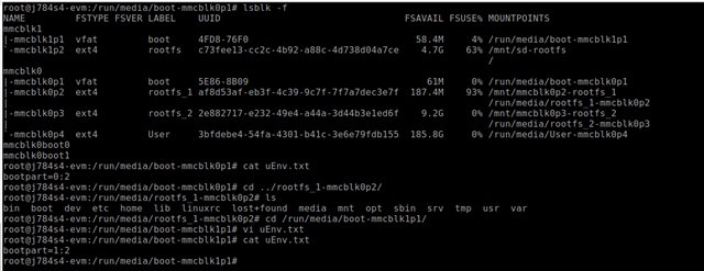

Hi Team,
 Board: Customised version of J784S4 EVM
SDK version : www.ti.com/.../09.02.00.05
Here, I am booting from eMMC in the board. But boot is getting stuck as default rootfs is mounting from SD-card.But if I interrupt at u-boot command prompt and give setenv bootpart 0:1, rootfs is getting mounted from eMMC,but I don't want to do manually everytime.
As part of that I want to achieve following.
1.I want to change that default rootfs access for eMMC bootmode from /dev/mmcblk0p1 partition.
2.I want to change the default access location of uEnv.txt for eMMC boot mode like uEnv.txt needs to be accessed from /dev/mmcblk0p1.
So, please specify the all possible ways to achieve these with exact file paths like where/which to modify.
Thanks & Regards,
Naradham Dharanija
  • Hi Naradham ,
    setenv mmcdev 0
    setenv bootdev 0
    setenv bootpart 0:1
    setenv args_mmc "run finduuid;setenv bootargs console=ttyS2,115200n8 root=/dev/mmcblk0p1 rw rootfstype=ext4 rootwait"
    You can add the above commands to the uEnv.txt file and it would change the default rootfs acces to /dev/mmcblk0p1.
    You will need to have an additional FAT32 partition in eMMC UDA parition in order to store uENV.txt in eMMC as the envboot command in uboot responsible for fetching the uENV.txt file uses the fatload command. Your /dev/mmcblk0p1 partition is EXT4 right since it contains the rootfs.
    An alternative which I would suggest would be to store the uENV.txt in the FAT32 partition of SD card after adding the above mentioned commands.
    Gokul
  • Hi Gokul,
    Thanks for the reply.
    I want to mount the rootfs from the eMMC automatically without interrupting at u-boot and completely without SD card inserted.
    So, as you suggested I have added that content into uEnv.txt, which is residing in mmcblk0p1 of FAT32 type.
    Content added:
    setenv mmcdev 0
    setenv bootdev 0
    setenv bootpart 0:2
    setenv args_mmc "run finduuid;setenv bootargs console=ttyS2,115200n8 root=/dev/mmcblk0p2 rw rootfstype=ext4 rootwait"
    And my rootfs is residing in mmcblk0p1 of ext4 type.
    FYI, adding bootpart=1:2 or bootpart=0:2 is sufficient enough to mount the rootfs from respective device:partition, tested and confirmed.
    But here the issue is boot is defaultly trying to access the uEnv.txt of /dev/mmcblk1p1 (FAT32) not from the /dev/mmcblk0p1 eventhough mmcblk0p1 having uEnv.txt.And boot is getting stuck if SD card is removed.
    Bootlogs (If sd card removed and uEnv.txt is available in mmcblk0p1 and rootfs is in mmcblk0p2)

    So.for this what are the modifications I need to enable from u-boot source code to access uEnv.txt from eMMC instead of SD card defaultly .
    Clearly ,
    Uenv.txt needs to be accessed from SD card (/dev/mmcblk1p1) in SD-card boot mode.
    Uenv.txt needs to be accessed from eMMC(/dev/mmcblk0p1) in eMMC boot mode.
    Thank you.
