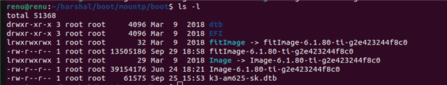

I am encountering an issue with the AM62x during the secure boot process after flashing the HSSE image and successfully flashing the ext4 filesystem.
When I run the following commands:
setenv mmcdev 0
setenv bootpart 0
saveenv
boot
The board boots successfully once, then reboots automatically 2-3 times. After these reboots, the terminal output hangs midway during boot, and the system becomes unresponsive.
I would appreciate any insights or suggestions on how to diagnose and resolve this issue.

  • Could you please share the logs?
  • => saveenv
    Saving Environment to MMC... Writing to MMC(0)... OK
    => boot
    switch to partitions #0, OK
    mmc0(part 0) is current device
    Failed to load 'boot.scr'
    Can't set block device
    starting USB...
    Bus usb@31100000: generic_phy_get_bulk : no phys property
    Register 1000840 NbrPorts 1
    Starting the controller
    USB XHCI 1.10
    scanning bus usb@31100000 for devices... 1 USB Device(s) found
           scanning usb for storage devices... 0 Storage Device(s) found
    ** Bad device specification usb 0 **
    Couldn't find partition usb 0:1
    8408718 bytes read in 63 ms (127.3 MiB/s)
    name_fit_config=conf-ti_k3-am625-sk.dtb
    ## Loading kernel from FIT Image at 90000000 ...
       Using 'conf-ti_k3-am625-sk.dtb' configuration
       Verifying Hash Integrity ... fit_config_verify_required_keys: No signature node found: FDT_ERR_NOTFOUND
    Bad Data Hash
    ERROR: can't get kernel image!
    Scanning mmc 0:1...
    MMC: no card present
    No EFI system partition
    Failed to persist EFI variables
    Could not get PHY for ethernet@8000000port@1: addr 0
    am65_cpsw_nuss_port ethernet@8000000ethernet@8000000port@1: phy_connect() failed
    am65_cpsw_nuss_port ethernet@8000000ethernet@8000000ethernet@8000000port@1: phy_connect() failed
    BootOrder not defined
    EFI boot manager: Cannot load any image
    Device 0: unknown device
    am65_cpsw_nuss_port ethernet@8000000ethernet@8000000ethernet@8000000ethernet@8000000port@1: phy_connect() failed
    am65_cpsw_nuss_port ethernet@8000000ethernet@8000000ethernet@8000000ethernet@8000000ethernet@8000000port@1: phy_connect() failed
    am65_cpsw_nuss_port ethernet@8000000ethernet@8000000ethernet@8000000ethernet@8000000ethernet@8000000ethernet@8000000port@1: phy_connect() failed
    am65_cpsw_nuss_port ethernet@8000000ethernet@8000000ethernet@8000000ethernet@8000000ethernet@8000000ethernet@8000000ethernet@8000000port@1: phy_connect() failed

    I've progressed with the board booting, and it now reaches the login prompt. However, I faced an issue related to the FIT image booting that I'd like to report in case it's relevant or needs fixing.
     Problem Summary:
    • I attempted to boot using the run run_fit command.
    • The environment variables were reset to default (env default -a, then saveenv, reset).
    • I set the necessary variables like:
      setenv name_fit fitImage
      setenv addr_fit 0x90000000
      load mmc 0:1 ${addr_fit} /boot/${name_fit}
    • Then I ran:
      run run_fit
      But I received this error:
      conf-: No match
      Bad Data Hash
      Workaround (for now):
      I was able to boot the system by disabling FIT image verification:
      setenv verify no
      saveenv
      boot
      After that, the board booted fine and reached:
      b2qt-am62xx-evm login:

  • Why does run run_fit fail with hash/signature errors on the FIT image?
    Most likely, your A53 U-Boot doesn't have the signature node required for authenticating the fitImage. Please make sure you rebuilt the A53 U-Boot after generating the fitImage as mentioned here:
    software-dl.ti.com/.../Foundational_Components_Kernel_Users_Guide.html
  • If you are in doubt, please see how the SDK's top level makefile generates the fitImage and rebuilds the A53 U-Boot
    github.com/.../Makefile_linux

    Below is the Screenshot of boot directory
  • What is the size of the Kernel Image with which the fitImage is built?
    If it is greater than 32MB then the boot will fail as the kernel is loaded at 0x81000000 while DTB is loaded at 0x83000000 which gives only 32MB maximum for Kernel image.
    Thanks for pointing that out.
    We checked, and our Kernel image size is approximately 39MB, which does indeed exceed the 32MB limit between the default load addresses (0x81000000 for the Kernel and 0x83000000 for the DTB). This likely explains the boot loop we're encountering.
    Also, please note that we have not yet optimized the Kernel image — it's currently a full build without any size reduction measures.
    Could you please advise on the recommended way to handle this?
    • Should we modify the Kernel load address to accommodate the larger image?
    • If so, what changes are needed on the U-Boot side ?
    • Alternatively, is it suggested to reduce the Kernel size ?
  • Try changing the DTB load address to 0x84000000 in the fitImage its file which allows 48MB for kernel image. No other changes should be needed.
    The default kernel image in the SDK v9.2 is 19MB so you may want to see why you have this large kernel image.

  • Can you share the Linux Kernel and the DTB image you used to generate the fitImage?
  • Image.gz

  • This is not the DTB file with which the fitImage was built. You may check that the size of the shared DTB does not match the size of the DTB (Data Size:    59528 Bytes = 58.1 KiB), parsed from the fitImage, mentioned in the logs.
    Can you please make sure to share the correct set of images?
  • Hi Prashant,
    Thanks for pointing out the issue with the DTB file. The one I provided earlier did not have the embedded hardware changes. We realized that we were using the TI-generated DTB instead of our custom DTB, which led to the issue.
    We corrected this by overwriting the DTB used in the fitImage with our custom one, rebuilt the fitImage and U-Boot, and reflashed the board.
    I'm happy to share that the system is now booting successfully!
