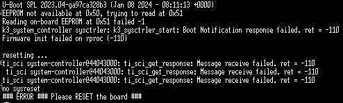

Hi, I am currently trying to use the AM64x EVM board.
I'm attempting to boot it using an SD card, but as shown in the captured screen, it gets stuck and does not proceed any further.
The binary file I used is "tiboot3-am64x-gp-evm.bin", and the SDK version is "09.02.00.08".

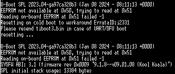

When I used the other binary files, "tiboot3-am64x_sr2-hs-evm.bin" and "tiboot3-am64x_sr2-hs-fs-evm.bin", logs were printed as shown in the screenshot below.
Please let me know what the possible issue might be.
Could this problem be related to DDR?
I would appreciate it if you could check.
