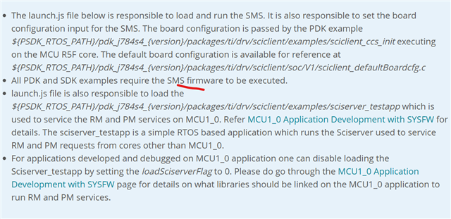

    I saw this in ccs setup documentation,
    My question is if I want to load my own firmware (that runs on FREE RTOS) do we need this SMS and MCU1_0 to be loaded? Can I directly load my own firmware without this mcu1_0 and system firmware getting loaded from launch.js or cmm files?
    What is written here is the TI firmware MUST be running on the Cotex-M core (TIFS) in order to execute any PSDK applications on other cores.   The flow is the .js file loads up the firmware on the M4-TIFS, the R5-MCU1_0 starts an application which initializes the firmware on the M4 with an init message (kind of like start w/config), then other cores can run PDK examples which make service calls to the MCU1_0.   The MCU1_0 can only handle a subset of service calls and sometimes has to make a call into the M4-firmware.   If you want to run an application on MCU1_0, you can create a build which skips loading the ~dummy-service-provider (loadSciserverFlag=0 and execute it directly.
