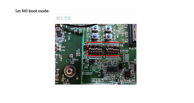

I am trying to flash mine AUTOSAR build application to MCU2_1 with jacinto v7.2.0.6 PSDK.
After launching launch.js for J721E I get following error:
MCU_Cortex_R5_0: Trouble Reading Memory Block at 0x18e59ff0 on Page 0 of Length 0x4: (Error -1205 @ 0x18E59FF0) Device memory bus has an error and may be hung. Verify that the memory address is in valid memory. If error persists, confirm configuration, power-cycle board, and/or try more reliable JTAG settings (e.g. lower TCLK). (Emulation package 20.0.0.3178)
MCU_Cortex_R5_0: Trouble Reading Memory Block at 0x410163a4 on Page 0 of Length 0x4: (Error -1205 @ 0x410163A4) Device memory bus has an error and may be hung. Verify that the memory address is in valid memory. If error persists, confirm configuration, power-cycle board, and/or try more reliable JTAG settings (e.g. lower TCLK). (Emulation package 20.0.0.3178)
MCU_Cortex_R5_0: Trouble Reading Memory Block at 0x41c1c214 on Page 0 of Length 0x4: (Error -1205 @ 0x41C1C214) Device memory bus has an error and may be hung. Verify that the memory address is in valid memory. If error persists, confirm configuration, power-cycle board, and/or try more reliable JTAG settings (e.g. lower TCLK). (Emulation package 20.0.0.3178)
And since R5_0 core is hitting main then I try to program my binary to MAIN_Cortex_R5_0_1 and then get additional error:
MAIN_Cortex_R5_0_1: Trouble Reading Memory Block at 0x9719e00c on Page 0 of Length 0x4: (Error -1205 @ 0x9719E00C) Device memory bus has an error and may be hung. Verify that the memory address is in valid memory. If error persists, confirm configuration, power-cycle board, and/or try more reliable JTAG settings (e.g. lower TCLK). (Emulation package 20.0.0.3178)
MAIN_Cortex_R5_0_1: File Loader: Verification failed: Target failed to read 0x9719E00C
MAIN_Cortex_R5_0_1: GEL: File: (...)\StartApplication\Appl\StartApplication.out: Load failed.
Can you support me to debug the problem? Boot config pins are setup to NO Boot:
Thank you and Best Regards,
Tomislav
  • Hi Tomislav,
    Are you able to see the "Happy Debugging!!" log from running the launch.js script?
    Since you are using SDK 7.2, I would recommend testing with an older version of CCS. Based on the documentation, SDK 7.2 was tested and validated on CCS version 9.3. It has not been tested or validated for CCS 12.8 as this is a new version for the newest SDKs. Could you test with CCS version 9.3?
    Neehar
  • Hello Neehar,
    I have installed CCS9.3 and didn't make a change. But what did make a change is setting loadSciserverFlag to 0 in launch.js file. I believe the problem was SciServer was loaded there and then since I want my AUTOSAR application to run on it it failed during overwrite.
    Now I am able to reach main( in debugger but when target is run eventually it jumps to 0x4 address and from there to 0x0. Do you know what could be the issue?
    IMO it could be due to some wrong placement of rst and interrupt vector tables. I have used RESETVECTOR placement refference from Jacinto PSDK 7.2. and here is the .ld file used. Could you crosscheck if all the dependencies are correctly placed for MCU_R5_0 core?
