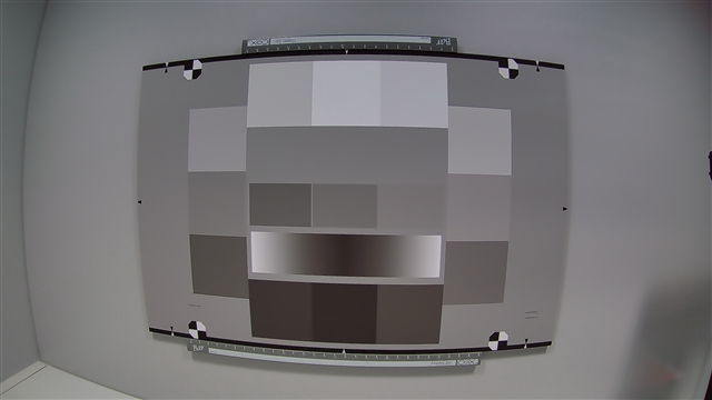

We find picture with low contrast portion can't be sharpened. Could you help to check attahed jpg and tell me if there is EE parameters to improve it.
Do you mean low contrast edges cannot be sharpened?
EE has to be able to detect the edge first before sharpening.
If you lower the detection threshold to include low contrast edges, you may suffer more from amplifying noise.

Is there any other threshold about detection threshold?
For ES, there is "edge_sharpener_hpf_low_thresh".
