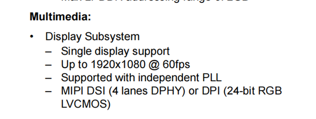

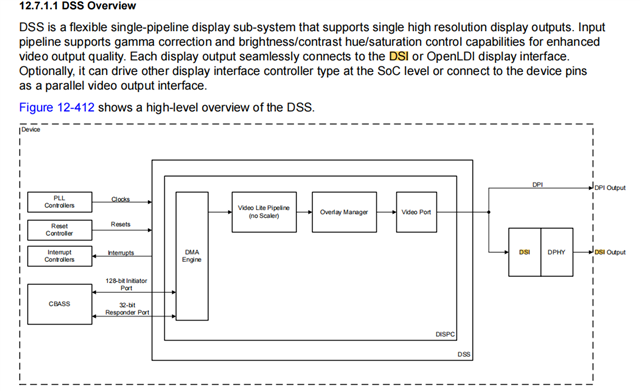

Dear Expert, I would like to reach out to you regarding the display interface of AM62L. I would appreciate it if you could provide some guidance.
Question 1: Can MIPI DSI and DPI be mutually exclusive? That is, can only one of them be used at the same time?
Question 2: Do the MIPI DSI and DPI interfaces support dual display?
