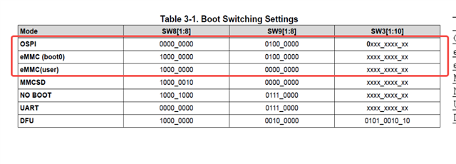

We encountered a problem while trying to boot the system from EMMC, as there was no output from the Linux serial port.

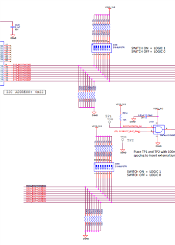

There is no problem with starting the SD card. Setting the dip switches SW8 and SW9 to the mode inside the red box in the middle of the bottom respectively will not start and there will be no logs.

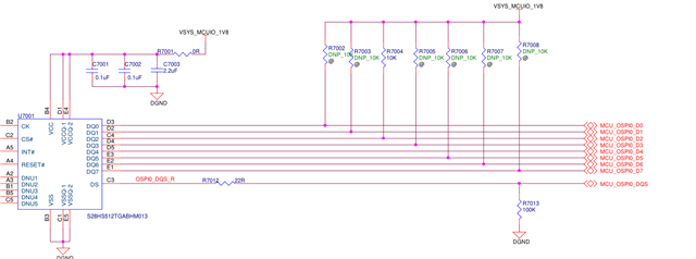

I have checked the current of NorFlash and there is no problem.

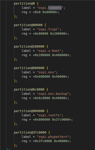

Here are the partitions of NorFlash, where I burned tiboot3, tispl, and u-boot.
