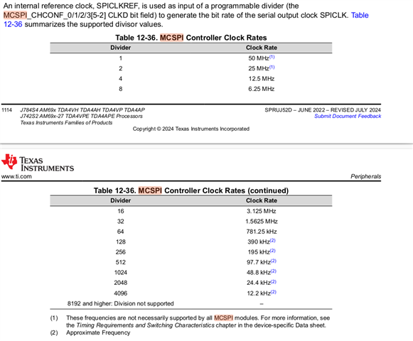

    McSPI clock has some hardware limitations for what clock it can divide down to. Would you be able to try to change clock to one of the clock rates in below table?

        mcspi->ref_clk_hz is 0.
    How can I make it get 50MHz or other non-zero values?
