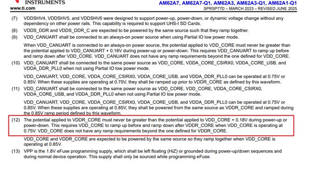

When I was testing the power-down sequence of AM62A7, I found that the manual has such a requirement: VDDR_CORE (0V85) needs to be always less than VDD_CORE (0V75) + 0.18V during the power-down process. That is, during the power-down process, I need to ensure that VDDR_CORE is powered off first before powering off VDD_CORE. Or, during the entire power-down process, the power-off rate of VDDR_CORE should be faster than that of VDD_CORE. Without additional discharge circuits, this is very difficult because the power-down time of the power supply is strongly related to the capacitance value of the attached capacitor.

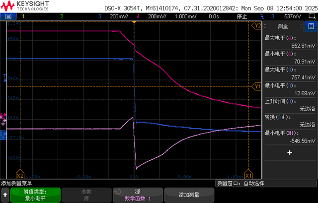

The following waveform is the actual measurement of the power-down timing sequence I conducted using the PMIC TPS65224. The red line represents VDDR_CORE, the blue line represents VDD_CORE, and the purple line represents the difference between VDD_CORE and VDDR_CORE. This subtraction value needs to always be greater than -0.18V. From the test waveform, it can be seen that this clearly does not meet the requirement; however, it can be confirmed that the power-down timing sequence can satisfy that the enable of VDDR_CORE is pulled down first, and then the enable of VDD_CORE is pulled down; and VDD_CORE is sourced from the BUCK circuit, while VDDR_CORE is sourced from the LDO circuit. The power-down rate of VDD_CORE is very fast.

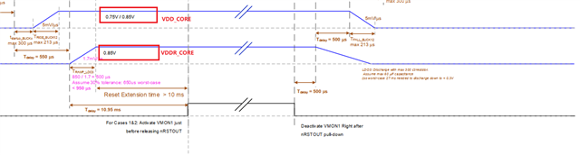

The following is the OTP timing diagram of TPS65224 combined with AM62A7. It can be seen that the power-down timing of OTP also fails to meet the required timing specified in the AM62A7 manual.

  • Hi Xiwen,
    The sequence requirements between VDD_CORE and VDDR_CORE must be followed during the power-up sequence. This is a hard requirement.
    For power down, we strongly recommend to discharge VDDR_CORE below ~300mV before turning-OFF the next rail in sequence (VDD_CORE). However, we don't have any data that would indicate an issue if VDD_CORE discharges faster than VDDR_CORE during power-down. This power-down requirement is included in the spec because having a potential on VDDR_CORE greater than VDD_CORE + 0.18V during power-down is not fully validated/characterized.

  • Hi,Brenda
    We enabled the 200Ω discharge path of PMIC(TPS65224) LDO3. However, the power-off test still failed to meet this requirement(It is recommended to discharge a supply group below ~300mV before the next rail in sequence is turned OFF.)
    The discharge speed of BUCK_CORE is much faster than that of LDO3.
    The power-on/off timing OTP of this PMIC is specifically designed by TI for use with AM62A7. We are unable to modify the OTP of the PMIC. Does your team have a better power solution to offer? Or are there any other ways of design optimization?

  • Hi Xiwen,
    To optimize the design even further, you could consider al logic implementation like the example below to add external discharge resistor to the rail that is discharging slow. It is strongly recommended to simulate any logic implementation before implementation.
