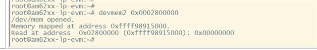

I use the tool devmem2 to read the MCASP register value, but it will core dumped.
but when read UART register memory, it is success
Is there any limit for MCASP , please help check

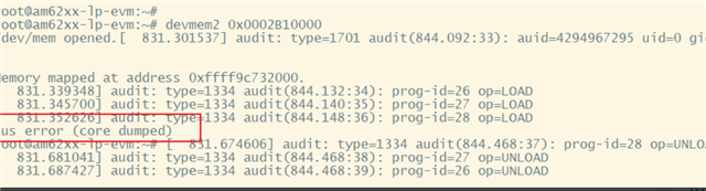

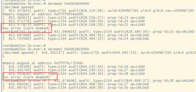

HI Suren
I use the TI EVM board SK-AM62-LP and run the Linux SDK 10.01.10.04, not change any code. you can try yourself

Hi Suren
0x0002B10000 is MCASP1, I have tried it . you can see the log above

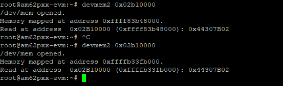

Hi Bert,
In order to dump the MCASP registers you need to be playing or capturing audio.
I was able to dump the register while executing the below commands:
arecord -D hw:0,0 -r 48000 -c 2 -f S16_LE test.wav -d 10
Hope this helps
