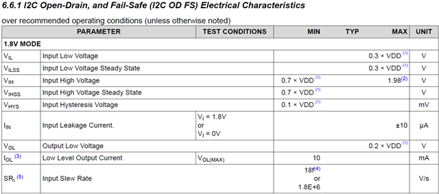

2. In sprsp96a Table 5-1 the following pins are listed as (only) having a buffer type "I2C OPEN DRAIN":
B23 EXTINTn
B13 MCU_I2C0_SCL
E11 MCU_I2C0_SDA
F25 PCIE0_CLKREQn
B9 WKUP_I2C0_SCL
D11 WKUP_I2C0_SDA
However, all of these are listed as GPIO capable (Mux Mode = IOD). Please confirm whether these pins are able of driving output high when configured as GPIO.

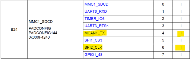

3. sprsp96a Table 5-1 has two GPIO-capable pins showing all mux modes as input-only:
B24 MMC1_SDCD
A24 MMC1_SDWP
Are the directions for the different Mux Types in the Table correct?
    Even though these are labeled as I2C Open Drain and the buffer type is IOD, you can still use these as regular GPIO pins as well.

    > You will only be able to use these pins as input.
    According to sprsp96a, B24 MMC1_SDCD can be set to the following functions:

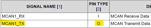

    The MCAN1_TX and SPI2_CLK functions are shown as input here in Table 5-1. However, in the later pin tables, these are shown as 'O' (Table 5-38) and 'IO' (Table 5-48) respectively:
    Which of these tables are correct, please?
    Similarly MMC1_SDWP, which can be set to:
    - UART6_TXD, shown as input in Table 5-1 at the MMC1_SDWP pin description, but as output in Table 5-78, similarly
    - TIMER_IO7 (I vs IO), and similarly
    - SPI1_CS1 (I vs. IO)
    Which information is correct, please?
    Thanks for bringing this up! This is an issue in the padconfig table, I would recommend following the pin types in Table 5 as those are correct.

    They are only listed as Open Drain Buffer Type [13] in Table 5-1:
    However, Section 6.6 does not have a VOH spec for this Buffer Type (which is to be expected, since it is Open Drain):
    Yet you say that they can be used as regular GPIO as well, implying that they are push-pull output capable, which therefore requires another Buffer Type in Table 5-1, if this is true:
    Please confirm.
    If Table 5-1 is correct, and pin B24 (for instance) can be input only, then how can this pin be used for MCAN1_TX (for instance), please? Which part of Table 5-1 is correct, the pin directions or the mux modes (taking pin B24 as an example, but this is also relevant for pin A24 (eg. as UART6_TX))? Are output-oriented Mux Modes (like MCAN1_TX or UART6_TX) for these two pins perhaps selectable but not actually useable since no output driver seems to be available on these pins?
  • Hi Bernhard,
    Please confirm.
    I have confirmed you can use these pins as any other regular GPIO and push-pull is handled internally. If pull-up is required, this will have to be handled with external resistors.
    Sorry for not being clear enough, I would recommend following the pin type in Table 5-38 and 5-48.
