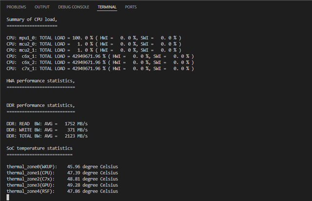

I am experiencing issues with my SK-TDA4VM board. Sometimes, while using it normally, the board seems to freeze completely. When this happens, I lose the SSH connection and, at the same time, the serial console also stops responding.
This issue happens repeatedly, usually when I am running something on the board. For example, I was transferring some files through the SSH connection, and the board froze several times during the process. I tested it multiple times and the same issue occurred.
More recently, I tried using ROS inside Docker with the TI Robotics SDK. When I run one of the commands from the documentation to start ROS, the board freezes again in the same way. Both SSH and serial communication are lost.
I already tried reinstalling the Linux SDK for Edge AI several times, thinking it could be a software issue. I even tested with an older release, but the same problem occurred, so I went back to the latest version (11.00.00.08).
I am not sure if this could be a hardware problem with my board or something else. Any suggestions on how I can debug or fix this?

  • Hi Mark,
    Here are the details you asked for:
    • I am currently using an SD card.
    • The board revision number reported in U-Boot is A1.
    • For the power supply, I am using a 20V/65W adapter (not exactly the same model as in the link you provided, but with the same specs).
    • Regarding the performance logs: I recorded a short video to better capture the behavior, and I extracted two frames as you can see below.

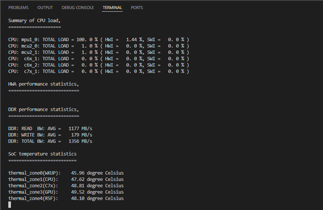

      Here, just before the freeze, the C6x and C7x cores show an extremely high and abnormal load values.
      And this is the exact moment of the freeze. The MPU shows 100% load, while the other cores look normal.

    I also ran the same performance log test, and the behavior was very similar to the first board.
    This seems to reinforce that the issue is not isolated to a single board, since I was able to reproduce similar failures on two different SK-TDA4VM units. I will also try with another SD Card to rule that out.
    Heverton
