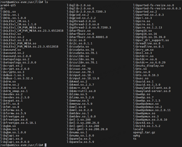

But when we use the kmscube command, the following error occurs The error message is that EGL configurations cannot be found, but we have already ported dependency libraries such as EGL and OpenGL. And before and after executing the kmscube command, the content displayed in cat/sys/kernel/debug/pvr/status is also different.

After I configure the Qt environment variables, our application will also report an error saying 'cannot find egl configs':
I would like to ask TI, what is the reason for the error of not being able to find egl configs, and is it related to me not using the display framework (Wayland/West)? Is the inconsistency in the content viewed by cat/sys/kernel/debug/pvr/status related to the unsuccessful loading of GPU drivers? Please ask TI experts to help me take a look, thank you!
