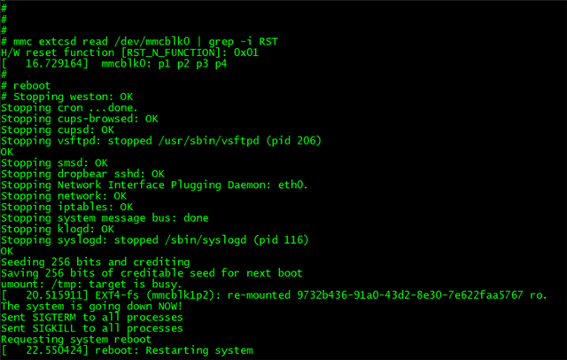

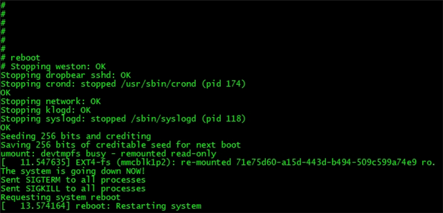

We are using custom board with PROCESSOR-SDK-LINUX-AM62X 11_01_05_03
When in SD boot mode rebooting is OK
But when in eMMC boot Mode, facing rebooting failed issue both in u-boot (reset) and linux (reboot)
  stuck @ Restarting system

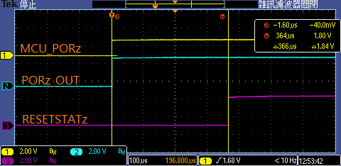

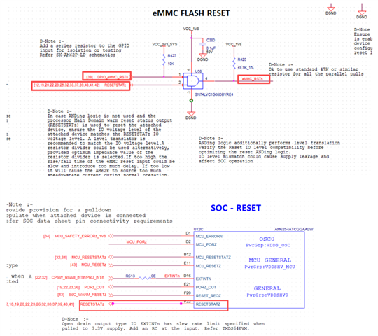

 [FAQ] AM62x: How to check and configure eMMC flash RST_N signal to support WARM_RESET from eMMC booting on AM62x-SK E2
Base on the FAQ, We have tried @U-boot: => mmc rst-function 0 1 but still FAILED
Is there anything we might miss?
