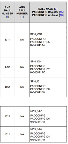

Hi Tony, one thing to keep in mind is that pinmux would be different. So, from https://www.ti.com/lit/ds/symlink/am62l.pdf we have:
Above should translate in something like below:
&main_pmx0 {
main_spi0_pins_default: main-spi0-pins-default {
pinctrl-single,pins = <
AM62LX_IOPAD(0x01a8 PIN_INPUT, 0) /* (E13) SPI0_CLK */
AM62LX_IOPAD(0x01ac, PIN_INPUT, 0) /* (E12) SPI0_D0 */
AM62LX_IOPAD(0x01b0, PIN_INPUT, 0) /* (B12) SPI0_D1 */
AM62LX_IOPAD(0x01a0, PIN_INPUT, 0) /* (E11) SPI0_CS0 */
Also, you would need to enable SPI0 controller, something like below:
&main_spi0 {
status = "okay";
pinctrl-names = "default";
pinctrl-0 = <&main_spi0_pins_default>;
#address-cells = <1>;
#size-cells = <0>;
/* Add your SPI device here */
spidev@0 {
compatible = "rohm,dh2228fv";
reg = <0>;
spi-max-frequency = <24000000>;
One thing is that in in the current AM62L3 EVM device tree, pins E12 and B12 are configured as GPIOs, as shown below, so you probably would need to remove them (or modify them) when enabling SPI0 to avoid conflicts:
AM62LX_IOPAD(0x01ac, PIN_INPUT, 7) /* (E12) SPI0_D0.GPIO0_90 */
AM62LX_IOPAD(0x01b0, PIN_INPUT, 7) /* (B12) SPI0_D1.GPIO0_91 */
