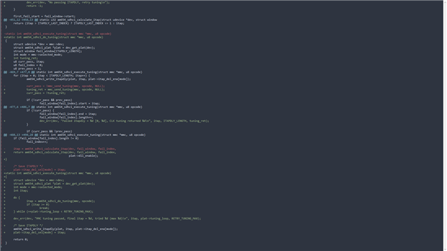

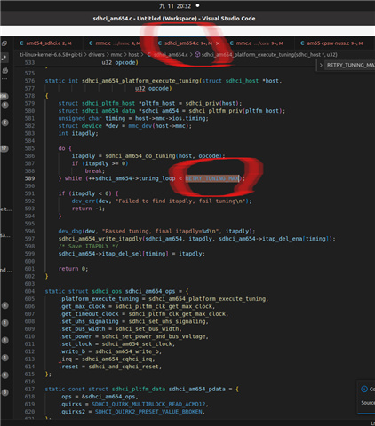

Hi, Dear Expert.
Customer suffer from eMMC boot issue, two error log (condition) as below.
Error 1 : system crash

Base on software debugging, we found add "RETRY_TUNING_MAX" times seems could solve this problem in u-boot
Original velue is 10, and then we may increase to 20.
* Linux kernel
/ti-processor-sdk-linux-am62xx-evm-10.01.10.04/board-support/ti-linux-kernel-6.6.58+git-ti/drivers/mmc/host/sdhci_am654.c
* We also modify (add) related MMC SW Tuning Algorithm code in to u-boot, it can solve this problem.
am62_lp/ti-processor-sdk-linux-am62xx-evm-10.01.10.04/board-support/ti-u-boot-2024.04+git/drivers/mmc/am654_sdhci.c

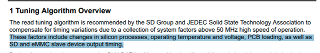

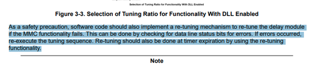

I also reference this document, and feel a little bit confuse about this description.
https://www.ti.com/lit/an/spract9a/spract9a.pdf?ts=1757592635363&ref_url=https%253A%252F%252Fwww.google.com%252F

(1) Why can we add "RETRY_TUNING_MAX" time to solve thie problem? Does it have any reason to do this workaround?
(2) How many RETRY_TUNING_MAX is reasonable?
(3) Why do we only implement  "MMC SW Tuning Algorithm" in Linux kernel SDHCI driver?

  • (1) Why can we add "RETRY_TUNING_MAX" time to solve thie problem? Does it have any reason to do this workaround?
    We have observed 10 loops were sufficient to pass tuning in corner cases, but you are free to change it to 20, it won't hurt anything other than takes longer time to complete the tuning, which is still better than fails in tuning.
    I believe the tuning won't need 20 loops on the custom board once the root cause of the issue is resolved.

    - Please apply the following U-Boot patch for HS200 itapdly tuning debug:
    diff --git a/drivers/mmc/am654_sdhci.c b/drivers/mmc/am654_sdhci.c
    index 8f1095539746..7a5218e46afe 100644
    --- a/drivers/mmc/am654_sdhci.c
    +++ b/drivers/mmc/am654_sdhci.c
    @@ -470,6 +470,7 @@ static int am654_sdhci_execute_tuning(struct mmc *mmc, u8 opcode)
                    am654_sdhci_write_itapdly(plat, itap, plat->itap_del_ena[mode]);
                    curr_pass = !mmc_send_tuning(mmc, opcode, NULL);
    +               printf("For itapdly=%d:%s\n", itap, curr_pass ? "PASS" : "FAIL");
                    if (!curr_pass && prev_pass)
                            fail_window[fail_index].start = itap;
    @@ -494,6 +495,7 @@ static int am654_sdhci_execute_tuning(struct mmc *mmc, u8 opcode)
            /* Save ITAPDLY */
            plat->itap_del_sel[mode] = itap;
    +       printf("final tuning point %d\n", itap);
            return 0;
