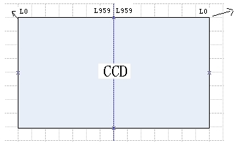

We using a CCD( Bayer raw format, 12bit/pixel, 1920X1080 ) that output via two channels. Each channel output line by line from L0 to L935.
We would like to connect the dual channel output CCD to two DM8148 VIPs. We wondering whether we can control EDMA’s args to mirror the right part channel image and merge the two image parts into a complete image at the same time。

  • I still need your  help on:
    1.  In our system, the resolution of CCD is  1920*1080, the output of each output channel is 960*1080. The pixel format is BAYER RAW, every pixel is 12bit.

  • for EDMA,
    1. use VIP0 to catpure half screen to buf0
    2 use VIP1 to capture the another half screen to buf1
    3. then SW uses EDMA to copy buf0  and buf1 to final buffer with proper rotation or mirroring
    yihe
