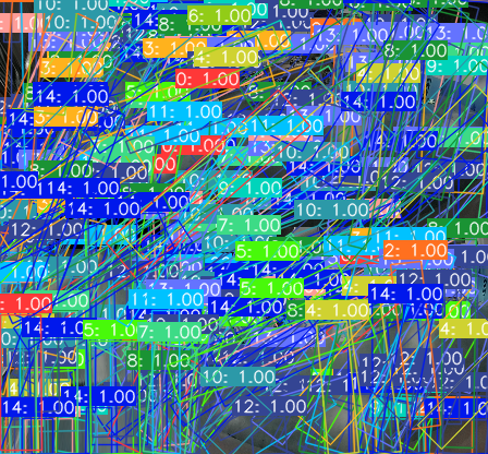

Hi, I have a question. When I compile my model with edgeai-tidl-tools version 11_00_06_00 and set tensor_bits = 8, the compiled model works fine (though the accuracy is too low). But when I change tensor_bits = 16, the compiled model becomes completely unusable.
I also tried adding some layers to output_feature_16bit_names_list, but as long as I add anything there, the compiled model cannot be used at all. Do you know why this happens?

  • 1.Below is the log when I set tensor_bits = 16 and debug_level = 2, running python3 onnxrt_ep.py -c -o. I didn’t see any obvious errors.
    2.For x86 PC simulation, should I run python3 onnxrt_ep.py? If yes, then the results on x86 PC are correct, but on AM67A they are not.
    3.The model artifacts for 8-bit mode are as follows:
    The model artifacts for 16-bit mode are as follows:
    4.I did not use meta_arch_type.
    5.When using output_feature_16bit_names_list, I set tensor_bits = 8.
    When tensor_bits = 16, the compiled model runs on AM67A but produces incorrect bounding boxes, like this:
    Understood, thanks.
    So please confirm for me: When you run on PC with tensor_bits=16 or with anything defined in output_feature_16bit_names_list, there is no issue compiling. When you run on PC, you see correct results. When you run on target, you get noisy, nonsensical output.
    Is this correct?
    Once you provide you logs and model-artifacts, I will take a deeper look and seek a workaround. If the above points are true, there is a bug that I will file with our team as well.

    Another question about the output with tensor_bits = 16:
    •  Are the values all within the expected range? i.e. confidence levels between [0,1), class numbers, box dimensions are within the frame
