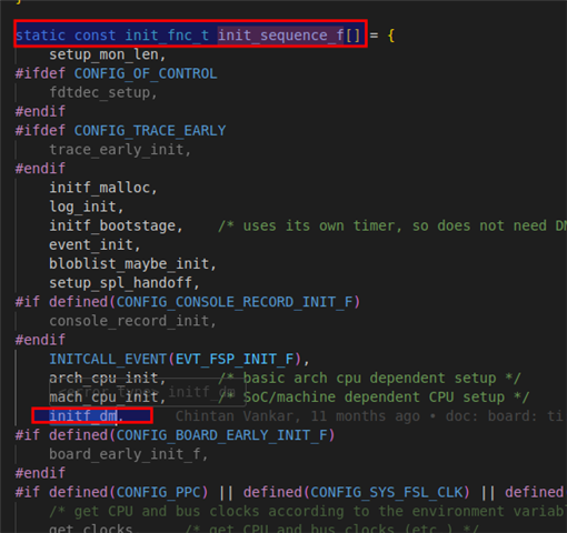

  • Hi cesar,
    My apologies for the delay. So after iterating through the code I found out that, the initf_dm function takes approx 722 ms .
    This function is responsible for initializing the devices nodes present in the device tree. This is why there is more than 1 sec delay as this function takes major chunk of time. This function  is called in UBOOT before the UBOOT print comes up. Hence it is not the image loading time , but instead it is the initialization time taken based on the devices mentioned in the device tree.
    Gokul
  • Hi Gokul,
    The size of all the dtb files is approximately 100kB. Why does initialization take so long.
    Cesar

  • HI Cesar,
    I had used a GTC clock and stored the timestamps before and after the initf_dm function in 2 variables. After that I printed the the difference between those 2 variables after the serial_init function was called.
    Gokul
  • Hi Gokul,
    Could you provide the relevant patch? I'm planning to test it myself as well.
    Cesar
  • Hi Cesar,
    I am attaching the patch for the same below:
    diff --git a/common/board_f.c b/common/board_f.c
    index 442b8349..296e19ef 100644
    --- a/common/board_f.c
    +++ b/common/board_f.c
    @@ -49,9 +49,13 @@
     #include <dm/root.h>
     #include <linux/errno.h>
     #include <linux/log2.h>
    +#include <time.h>
     DECLARE_GLOBAL_DATA_PTR;
    +u32 start_time,end_time,time_taken;
      * TODO(sjg@chromium.org): IMO this code should be
      * refactored to a single function, something like:
    @@ -108,6 +112,19 @@ int init_func_watchdog_reset(void)
     #endif /* CONFIG_WATCHDOG */
     __weak void board_add_ram_info(int use_default)
            /* please define platform specific board_add_ram_info() */
    @@ -201,6 +218,9 @@ static int print_cpuinfo(void)
     static int announce_dram_init(void)
    +       printf("initf_dm_scan time(in ms):%d ms\n", time_taken);
            puts("DRAM:  ");
            return 0;
    @@ -827,8 +847,12 @@ static int initf_dm(void)
     #if defined(CONFIG_DM) && CONFIG_IS_ENABLED(SYS_MALLOC_F)
            int ret;
    +       start_time = get_timer(0);
            bootstage_start(BOOTSTAGE_ID_ACCUM_DM_F, "dm_f");
            ret = dm_init_and_scan(true);
    +       time_taken = get_timer(start_time);
            bootstage_accum(BOOTSTAGE_ID_ACCUM_DM_F);
            if (ret)
                    return ret;
    Gokul

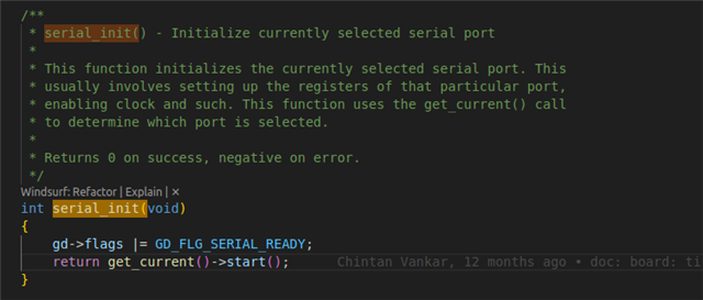

  • Hi Gokul,
    It was confirmed that the serial_init process took more than 700 milliseconds.
    serial_init,       /* serial communications setup */
    Could you please help me figure out why the serial_init takes so long?
    Cesar
  • Hi cesar,
    Sorry for the late reply.
    This is what serial_init does. It initializes the serial device which might be taking more time.
    Gokul
  • Hi Gokul,
    Could you please help check why the initialization of the serial port takes so long?
    Cesar
  • Hi cesar,
    The serial port is taking long because of setting up the registers and enabling clocks as mentioned in the function comments.
    Gokul
