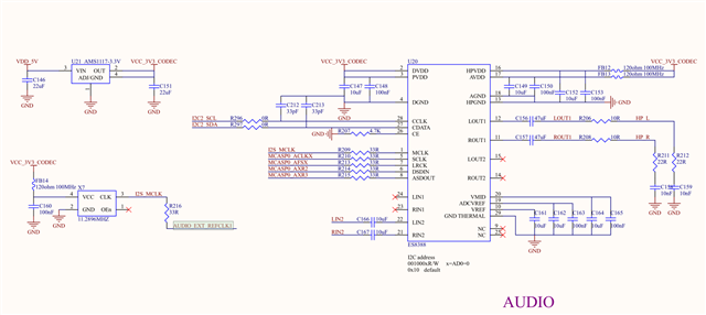

Hello, I am currently debugging the audio function of the AM6234. The audio chip used on the board is the ES8388, connected to the main_i2c2 of the AM6234. The audio interface is connected to the mcasp0 of the AM6234. Hardware-wise, an external 11.2896 MHz crystal oscillator is connected to the MCLK of the ES8388 and the AUDIO_EXT_REFCLK1 of the AM6234. The schematic diagram is as follows:
The device tree configuration is as shown in the attachment.

	es8388: es8388@10 {
		pinctrl-names = "default";
		pinctrl-0 = <&audio_ext_refclk1_pins_default>;
		compatible = "everest,es8388";
		reg = <0x10>;
		#sound-dai-cells = <0>;
		clocks = <&clk_es8388_fixed>;
		// clocks = <&audio_refclk1>;

&audio_refclk1 {
	status = "okay";
	// assigned-clock-rates = <11289600>;
	clocks = <&k3_clks 157 10>;
	assigned-clocks = <&k3_clks 157 10>;
	assigned-clock-parents = <&clk_es8388_fixed>;
	// assigned-clock-parents = <&k3_clks 157 18>;
&mcasp0 {
	pinctrl-0 = <&main_mcasp0_pins_default>;
    status = "okay";
	op-mode = <0>;          /* MCASP_IIS_MODE */
	tdm-slots = <2>;
	DEV_MCASP0_MCASP_AHCLKR_PIN	DEV_MCASP0_MCASP_AHCLKR_PIN_PARENT_BOARD_0_AUDIO_EXT_REFCLK1_OUT
	DEV_MCASP0_MCASP_AHCLKX_PIN DEV_MCASP0_MCASP_AHCLKX_PIN_PARENT_BOARD_0_AUDIO_EXT_REFCLK1_OUT
	// clocks = <&k3_clks 190 9>;
	// clock-names = "fck";
	// assigned-clocks = <&k3_clks 190 9>;
	// assigned-clock-parents = <&k3_clks 190 13>;
	// assigned-clocks = <&k3_clks 190 9>, <&k3_clks 190 15>;
	// assigned-clock-parents = <&k3_clks 190 13>, <&k3_clks 190 19>;
	// assigned-clock-rates = <11289600>, <24576000>;
	/* 16 serializers */
	serial-dir = <  /* 0: INACTIVE, 1: TX, 2: RX */
		0 0 1 2
		0 0 0 0
		0 0 0 0
		0 0 0 0
	tx-num-evt = <32>;
	rx-num-evt = <32>;

After the system boots up, audio recording and playback are not working.
When using arecord to record audio, the following error is reported:
When using aplay to play audio, there is no sound, and the program hangs indefinitely until terminated with Ctrl+C.
Please help check if there is any issue with the device tree configuration. I am currently using Linux SDK version 11.00.09.04.
