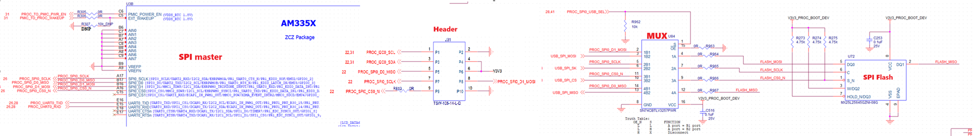

Schematic: Master is PROC AM3352 U3, the SPI0_CLK goes from PROC to the MUX U84 . The output of the MUX goes to the SPI slave U72. There is also a header J31 on this SPI0 bus for measurement. On PCB, the trace goes from U3->J31->U84.

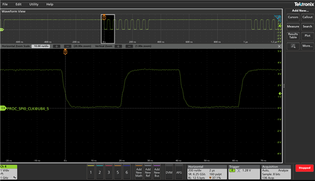

At the beginning, we suspect if there is big overshoot on PROC_SPI0_CLK, so we measured this net on the destination(U84.5 pin), the waveform is perfect, no overshoot, no undershoot. See the waveform below.

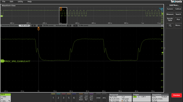

How does PROC (master) side samples the MISO signal?  Is it sampled by the SPI0_CLK on PROC’s pin or is it sampled by PROC internal clock before the output flip-flop? Can you please help to share the internal block diagram for SPI0_CLK. We measured PROC_SPI0_CLK on the source side(AM3352 A17 pin).  There is ditch on the rising and falling edge of SPI0_CLK.  If the MISO is sampled on the SPI0_CLK on the output pin, the ditch may cause problem.

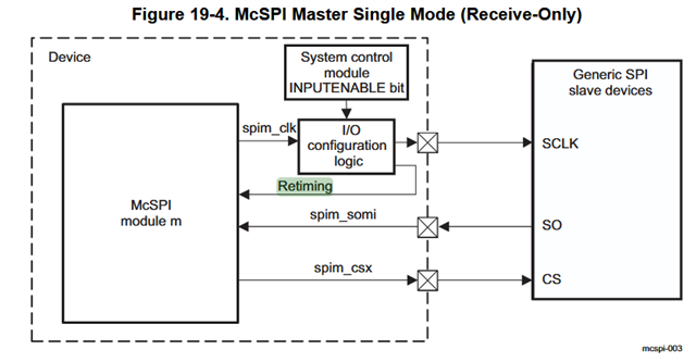

    I can remember we were inserting the following return paths to the figures for many peripherals in the TRMs from that era. I can see this didn't reach the AM335x TRM, however would tend to say yes, the controller uses the clock returned from the pin.
    This a MCSPI diagram from OMAP35 TRM, a device close to AM335x in terms of classic peripheral modules.

     We made some experiments trying to tune the distortions of Clock on source side, then see if the board can bootup or not. There are something I don't quite understand. See experiment3. The distortion is even bigger but the board still can bootup. (All the waveform below are measured at AM352 pin.(source side)
    For original case, the board failed boot up. There is some distortion on SPI0_CLK when measured at AM352 pin. See the waveform below:
    Experiment1: we added a 3.6pF cap on SPI0_CLK at J31 pin, the distortion seems smaller,  and the board boot up successfully
    Experiment2: Inserting a 33ohm resistor on SPI0_CLK, the distortion decreased and it makes board bootup successfully
    Experiment3: Then I tried increase the distortion then see if the board will fail bootup. I tried add a 22PF on SPI flash pin, the distortion becomes bigger but the board still can bootup successfully.
    Furthermore, I added a 470ohm on J31 to make the distortion even bigger,but the board still can bootup.

  • The waveform on the device side(SPI flash) are all good. No overshoot, no undershoot, no distortion. Even when the board failed bootup, the SPI0_CLK on device side are good. See the waveform.

    I captured a more clear waveform of SPI0_CLK for you.
    The green waveform is captured on the original board which failed boot up.
    The blue one is captured after I added the 22pF on SPI0_CLK at SPI flash pin. Although the distortions is bigger, the board can boot up successfully everytime.
    The waveform are all captured at AM352 pin. (The waveform on SPI flash pin is all good)
    Jie Wang
  • Sorry, I had a typo. The Blue waveform is captured on the original board which failed bootup. The green one is captured after I added the 22pF and the board can boot up successfully.
  • I had a typo. The green waveform is captured after adding 22pF. The blue one is captured on original board which failed bootup.

  • Hello Jie Wang
    Please refer below update from the expert:
    The non-monotonic distortion on the looped back clock pin will result in a clock glitch inside the device if the non-monotonic distortion over-laps the input buffer’s switching threshold and the amplitude of this distortion is greater than the input buffer’s hysteresis.  The synchronous logic circuits in the SPI module can be over-clocked if the duration of the glitch is short.  Unpredictable behavior will occur if portions of the logic see the clock transition while other portion of the logic do not see the clock transition.
     The customer’s attempt to increased distortion also appears to be increasing the duration of the distortion.  This is most likely creating a longer glitch that allows all of the logic to see the clock transition.
     The best solution is to place a series 22 – 33 ohm resistor as close as possible to the AM335x pin (less than 200mils).  This shifts the non-monotonic step to a high voltage on rising edges and a lower voltage on falling edges, which shifts the distortion away from the input buffer’s switching threshold.
