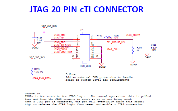

In the schematic of SK-AM64B, in the 20-pin jtag connector, from where does the signal SEL_XDS110_INV come, and what is its functionality?
Hello Balagopalan,
Thank you for the query.
XDS110 is the on-board USB based debugger.
Let me review and update you.
Sreenivasa
Hello Balagopalan,
The signal is shown on the JTAG connector.
Please trace the signal to understand that the signal is used to select between external JTAG connector and on-board debugger.
Sreenivasa
Hello Balagopalan,
Thank you.
it is not a standard debug signal.
it is expected to be controlled from outside.
Sreenivasa
