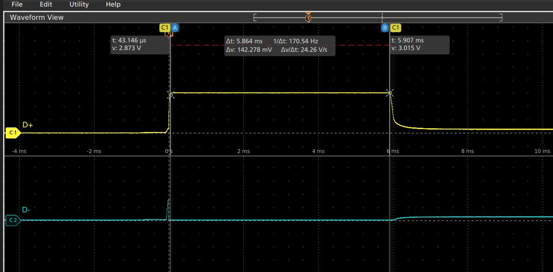

During AM5718 power up, before it asserts USB2_DRVVBUS signals to enable external USB power switch to supply 5V to USB port, the AM5718 chip output a short pulse on (USB2_DP), about 5ms~6ms long, 3V amplitude (see picture below, no external USB device connected).  The GPIO7_24 (ID) is pulled-down to GND with 10K resistor.
Is this a normal behavioral of AM5718? Or there is way to remove this pulse?

  • Hi, Karthik,
    When this D+ pulse happens, the VBUS has not come up yet (see attached picture below).
    On PCA, there is no external pull-up resistors and no external active component connected to D+ trace from AM5718 chip and USB port connector.
    Recently there are some downstream device USB port damage cases (The device is connected to the host always, and powers up with host). The device supplier suspects the unexpected pulse on D+ before VBUS comes up could damage the device.

  • Hi Shreyas,
    This is observed on all devices during power-up, also observed on AM571x IDK.
    We observed client device damage, and the device supply thinks this pulse violates the USB port power-up sequence and could damage the chip.

  • Hi, Shreyas,
    This pulse is from AM5718 during its power up w/o client device physically connected. It is AM5718's own behavioral, not relevant to external client device's pull-up.
