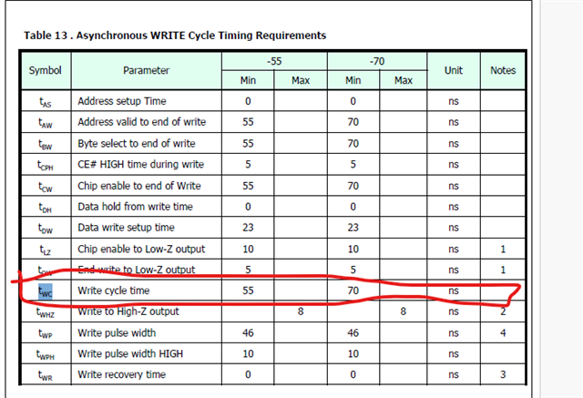

    We use FPGA to mimic NOR FLASH timing. We use 256MB of space and a 32 bit bus, and we do not use WAIT signal and DIR signal. The time interval between two write operations should be reduced to two clock cycles to meet the required throughput.
  • Hello ,
    You cannot force back-to-back single asynchronous write transactions to be only 2 GPMC cycles .
    The controller must wait until the device’s minimum write cycle completes, so your observed ~11 cycles (driver/ADV/address overhead + device min cycle) cannot be compressed to 2 cycles.
    Why 2 cycles is impossible in your setup :
    • PSRAM datasheet gives tWC / tACC ≈ 70 ns. At f_GPMC = 100 MHz a cycle = 10 ns → tWC = 7 cycles.
    The controller cannot start the next write until the current write cycle timing requirement is met.
    • AD-multiplexing (address phase) and small extra CS/WE hold times can add cycles, so seeing 11 cycles is expected.
    Practical ways to improve overall throughput :
    Use DMA :
    • Throughput gains are large because the per-transaction device timing (tWC) is still required, but you remove CPU inter-write delays and reduce AD/address overhead by doing long contiguous block writes.
    Anil.
