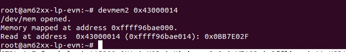

We are using the following image on SK-AM62-LP:
tisdk-default-image-am62xx-lp-evm-11.00.09.04.rootfs.wic
We are facing an issue with devmem2 for some addresses, it is able to read successfully, but for others, it shows an error.
For example:
root@am62xx-lp-evm:~# devmem2 0x30101028
/dev/mem opened.
[  495.513745] kauditd_printk_skb: 7 callbacks suppressed
Memory mapped at address 0xffffb5062000.
[  495.513767] audit: type=1701 audit(1756372941.641:22): auid=4294967295 uid=0 gid=0 ses=4294967295 subj=kernel pid=2112 comm="devmem2" exe="/usr/bin/devmem2" sig=7 res=1
[  495.558811] audit: type=1334 audit(1756372941.685:23): prog-id=21 op=LOAD
[  495.565719] audit: type=1334 audit(1756372941.693:24): prog-id=22 op=LOAD
[  495.572615] audit: type=1334 audit(1756372941.701:25): prog-id=23 op=LOAD
Bus error (core dumped)
Could you please suggest a solution to reliably read the SoC's CSI Rx registers?
