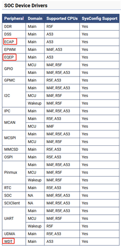

Can M4F use the Uart of the main domain?

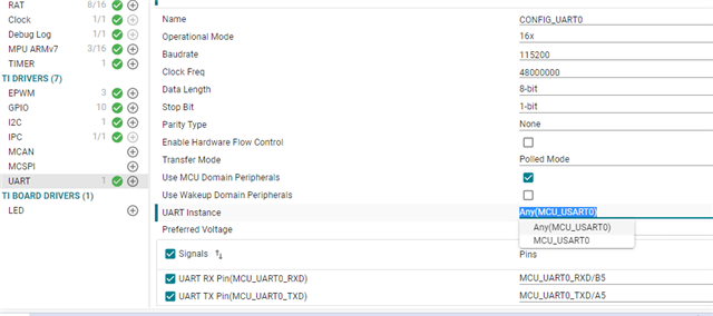

In the Soc Device table, the SDK is supported, but when configuring the M4F in ccs's syscfg, this option is not available
Hi Owens,
Could you try unchecking the "Use MCU Domain Peripherals" option in Sysconfig and see if it makes the Main-domain UART instances visible?
