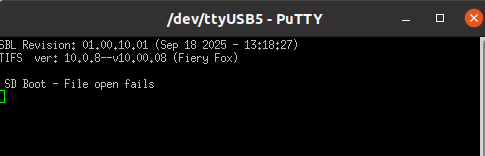

But I found boot failed.
MCU Uart log as below.
Do I miss anything?
Need your suggestion.

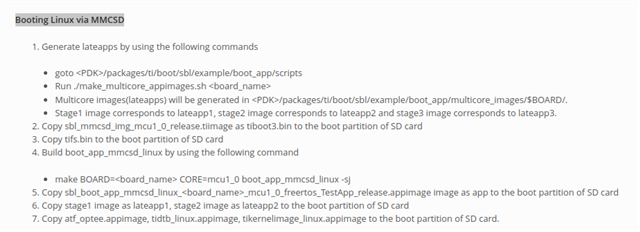

  • Hi Gibbs,
    I guess you have missed the 4th and 5th step in the process(ie: building and copying the bootapp step).
    Gokul
  • Hi, Gokul
    I make a mistake, you are right.
    It can work for me now.

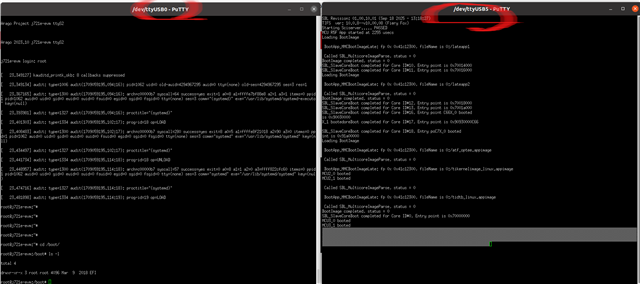

    After boot from SD, it seems boot failed, log as below.
    it seems hang on execute "lateapp1"
    Welcome to minicom 2.7.1
    OPTIONS: I18n
    Compiled on Dec 23 2019, 02:06:26.
    Port /dev/ttyUSB1, 15:04:47
    Press CTRL-A Z for help on special keys
    SBL Revision: 01.00.10.01 (Sep 18 2025 - 13:18:27)
    TIFS  ver: 10.0.8--v10.00.08 (Fiery Fox)
    Starting Sciserver..... PASSED
    MCU R5F App started at 2250 usecs
    Loading BootImage
     BootApp_MMCBootImageLate: fp 0x 0x41c12300, fileName is 0:/lateapp1
    Normal boot should be like below.
    MCU R5F App started at 2251 usecs
    Loading BootImage
     Called SBL_MulticoreImageParse, status = 0
    BootImage completed, status = 0
    SBL_SlaveCoreBoot completed for Core ID#10, Entry point is 0x70014000
    SBL_SlaveCoreBoot completed for Core ID#11, Entry point is 0x70016000
    Loading BootImage
     BootApp_MMCBootImageLate: fp 0x 0x41c12300, fileName is 0:/lateapp2
    SBL_SlaveCoreBoot completed for Core ID#12, Entry point is 0x70018000
    SBL_SlaveCoreBoot completed for Core ID#13, Entry point is 0x7001a000
    SBL_SlaveCoreBoot completed for Core ID#16, Entry point C66X_0 booted
    is 0x90030000
    SBL_SlaveCoreBoot completed for Core ID#17, Entry point is 0x90930000C66X_1 booted
    SBL_SlaveCoreBoot completed for Core ID#18, Entry poC7X_0 booted
    int is 0x91a00000
    Loading BootImage
     BootApp_MMCBootImageLate: fp 0x 0x41c12300, fileName is 0:/lateapp3
    SBL_SlaveCoreBoot completed for Core ID#0, Entry point is 0x70024000
    MPU1_0 booted
    Boot App: Started at 2471 usec
    Boot App: Total Num booted cores = 8
    Boot App: Booted Core ID #10 at 37477 usecs
    Boot App: Booted Core ID #11 at 38105 usecs
    Boot App: Booted Core ID #12 at 143610 usecs
    Boot App: Booted Core ID #13 at 144237 usecs
    Boot App: Booted Core ID #16 at 145077 usecs
    Boot App: Booted Core ID #17 at 145914 usecs
    Boot App: Booted Core ID #18 at 146558 usecs
    Boot App: Booted Core ID #0 at 154146 usecs
    MCU Boot Task started at 2471 usecs and finished at 168581 usecs
    MCU2_0 booted
    MCU2_1 booted
    MCU3_0 booted
    MCU3_1 booted
    lateapps booted successfully
    MCU2_0 reports: All tests have passed
    I think "LedBlink_TestApp_mcu2_0" or "I think "LedBlink_TestApp_mcu2_1" should be work failed, because I do not see any flash LED on EVB
    Do I miss any thing?
    Can any multicore image which we combained for booting? Any limition?
    Thank You.

  • Hi Gibbs,
    In your .map file for the GPIO Baremetal example, MCU2_0 and MCU2_1 share the same RESET_VECTORS address (0x41CE3000). In the original demo application, these addresses differ: MCU2_0 at (0x70014000) and MCU2_1 at (0x70016000). Did you observe the same lateapp1 hang issue when running both the original demo application and the GPIO Baremetal example?
    Karthik
  • Hi, Karthik
    Original demo link as below.
    It works for me, no app1 hangs.
    https://software-dl.ti.com/jacinto7/esd/processor-sdk-rtos-jacinto7/10_00_00_05/exports/docs/pdk_jacinto_10_00_00_27/docs/userguide/jacinto/boot/boot_app.html
    but lateapp1 hangs only happen when I use combined App image for "GPIO_Baremetal_LedBlink_TestApp_mcu2_0_release.rprc" and "GPIO_Baremetal_LedBlink_TestApp_mcu2_1_release.rprc". this is different lateapp from original one.
    Should I change reset vector to 41ce3000?
    if the answer is yes, How to do it?
    Thank You.
    Gibbs
  • Hi Gibbs,
    Sorry, I’m a bit confused. Earlier, you mentioned booting Linux via MMCSD, but now you’re referring to booting lateapps via MMCSD. Could you please clarify your requirement and explain why you’re using lateapps?
    Karthik
  • Hi, Karthik
    Sorry late reply and confuse you.
    Lets me explain the back groud.
    * Background
    I try to test quick boot w/o SPL, so the only choice is boot w/ SBL from media MMCSD or OSPI flash. Because there are some hw issues in my OSPI flash on EVB, so I test MMCSD first. Because I think the idea should be very similar. Base on customer requirment, application should be "booting Linux w/ SBL which include multi-core images from MMCSD (or OSPI flash) " or "booting multi-core images only w/ SBL from MMCSD (or OSPI flash)". Both of them include lateapps.
    * Testing / Goal
    I test default example (binary) step by step, it works for me. But basically, customer may change (build) their own applcation (EX: R5 Core, lateapp1, lateapp2 ... etc), so I try to test how to combined our customerized own multi-core images and boot them success. This boot scenario include booting Linux w/ SBL which include multi-core images from MMCSD (or OSPI flash) " and "booting multi-core images only w/ SBL from MMCSD (or OSPI flash)".
    I found even SBL boot w/ HLOS or not in default example, both of them use the same lateapps.
    Sorry, This is my fist time try to test multi-core images booting.
    If I do some think wrong, pls correct me.
    Thank You.
    Gibbs
  • Hi Gibbs,
    I noticed that your two app binaries are mapped to the same memory region, which can cause the boot to fail when they’re combined. You can check the IPC ipc_echo_test_freertos example  it uses different memory ranges for each core (like MCU2_0_DDR_SPACE = 0xA2400000 and MCU2_1_DDR_SPACE = 0xA3400000). Try updating your linker files so each app uses its own non-overlapping address range.
    Screenshot from 2025-10-15 11-46-35.zip
    ipc_echo_test_freertos_map.zip
    Karthik
