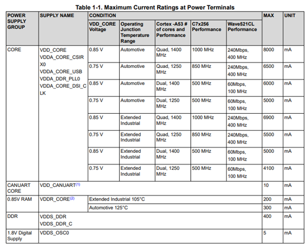

In Table 1-1 of the AM62Ax Maximum Current Ratings, there is a section that lists the current by pin.
Q1:Is this XXX[mA] for all pins in total? Or is it XXX[mA] for each individual pin?
Q2:If total, what is the maximum allowable current per pin?
