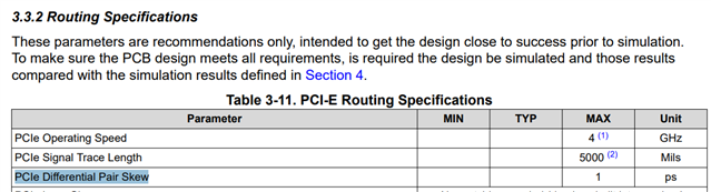

I would like you to confirm whether following requirement("Trace Length" and "Pair skew") should be applied to reference clock or not.
*www.ti.com/.../spracp4a.pdf
Customer will use external reference clock source(LP-HCSL) for PCIe. My concern is they need to follow this requirement not only TX/RX line but REFCLK as well.
