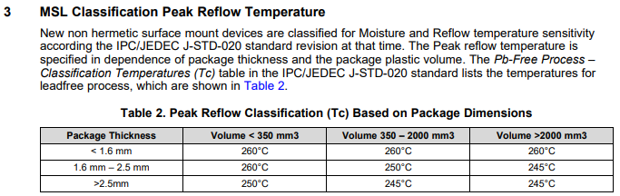

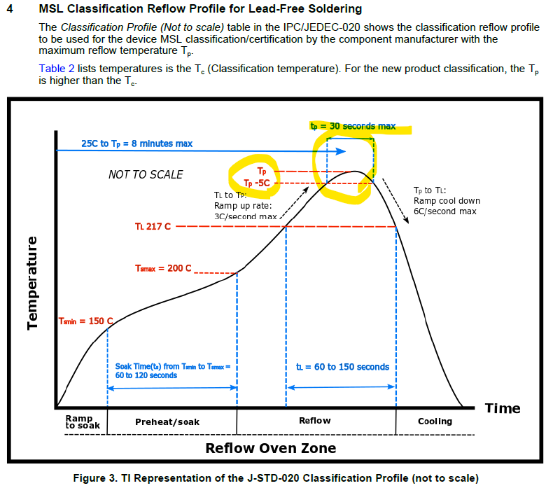

I have a question about the temperature/time of Tp, as shown in the screenshot below.
1) Is the typical reflow temperature for Tp 235°C to 250°C? Or is it the maximum temperature of 255°C to 260°C listed in Table 2 of the document?
2) In the Tp condition, it is written as 30 seconds max. Can you tell me the min seconds condition?
Please check. Thank you.
