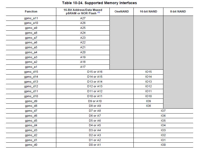

The main problem we are facing is that CPU is able to address first 128 kByte of NOR flash only.

As said before, CPU is able to address first 128 kByte of NOR flash only. This is due to the fact that CPU does not move GPMC_A17 and higher address lines that are stuck to 0 even if we try to access area at address 0x0802:0000 and higher. However if we change (via JTAG debugger) field GPMC_CONFIG1_0.MUXADDDATA to 0 (Non-multiplexed attached device), when accessing address 0x0802:0000 CPU moves GPMC_A17 as expected. Thus GPMC_A17 pad has no electrical problems.

  • Hi IIandre,
    I just found out that our TRM might be wrong, can you try this and let me know so I can change the TRM doc?  thanks.
    BR,
    Viet
  • I think the new tables you posted is correct.
    We are not able to test the NOR functonality (our PCB has been designed on erroneous documentation). However it seems that A1 actually acts as A17 when working in AD mode.

    We expect GMPC_A[12..1] pads (ball J28,K27,M24,L26,AD18,AC18,AC19,AA22,AE23,AD23,AB23,AF18) are configured as addresses as described in table 4-2. "XIP (on GPMC) Boot Options" on page 155 of datasheet SPRS647C. It seems they are configured in safe mode instead and pull-ups are enabled. This prevents U-Boot to be executed because CPU is not able to address NOR flash properly.
  • Hi
    Since A/D muxing is being used, BootROM doesnt configure the higher address lines as mentioned in the above table.
    Boot ROM only configures the AD0-AD15 lines.
    Higher address lines needs to be pulled low to access the NOR flash.
