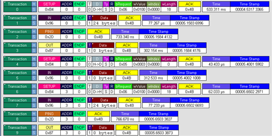

    I am not sure if you are aware but we have evaluation module (EVM) where customers and ourselves use to develop and run application. I used one of the EVMs and programmed USB0 as a Host and USB1 as a Device and performed enumeration transaction.
    I performed a GET DESCRIPTOR Command followed by SET ADDRESS command with Address ZERO. Then after performed GET DESCRIPTOR Command with Address 3. As you can see it worked well.

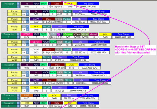

    Just to be on the same page: Are you using the device in Host mode or Device Mode. You mentioned that the address is Zero. I was under the impression that you were using the device as a Device. If you are using the device as a Host, you will need to program TXFUNCADDR[EP] and RXFUNCADDR[EP] registers for all endpoints. Endpoint 0 uses only TXFUNCADDR[0] and write to RXFUNCADDR[0] is not used. However, if using the device as a Peripheral then you will need to program only FADDR register.
    If you still are having a problem, please send me another capture where the SET ADDRESS command and the GET DESCRIPTOR command with the new address is expanded.
