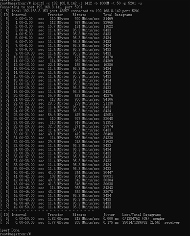

Hi TI.
On the TDA4VH platform ethfw CPSW9G for SDK0900, the hostmacport, macport1, and macport2 are configured within VLAN8.
The physical interface connected to MACPORT1 operates at 100MB,
while MACPORT2's connected PHY operates at 1000MB.
During our bandwidth testing of MACPORT2,
we encountered a bandwidth limitation issue where the throughput was restricted to 100MB
TDA4VH LINUX run command"iperf3 -c 192.168.8.142 -u -l 1412 -b 1000M -t 50" for UDP, However, TCP can reach 1000MB.
During UDP transmission, the count of octestframes1024 on MACPORT1 (0) increases sharply as MACPORT2 (1) grows.
    I could see in between throughput is higher and dropping, are you performing any data transfer in between Host Port to MAC Port-1.
    Also, can you please confirm the throughput test is with unicast frames right.
    Can you please check the same without VLAN as well.

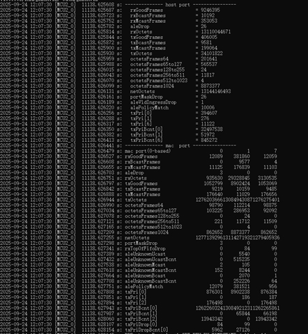

  • Hi dorela,
    This issue can also be reproduced without VLAN
    2022-01-02 02:08:17 [MCU2_0]   7703.778920 s: -------------- host port ----------------
    2022-01-02 02:08:17 [MCU2_0]   7703.778986 s:   rxGoodFrames            = 1042655
    2022-01-02 02:08:17 [MCU2_0]   7703.779021 s:   rxBcastFrames           = 1164
    2022-01-02 02:08:17 [MCU2_0]   7703.779050 s:   rxMcastFrames           = 61
    2022-01-02 02:08:17 [MCU2_0]   7703.779080 s:   aleDrop                 = 18
    2022-01-02 02:08:17 [MCU2_0]   7703.779112 s:   rxOctets                = 1579758522
    2022-01-02 02:08:17 [MCU2_0]   7703.779141 s:   txGoodFrames            = 2621
    2022-01-02 02:08:17 [MCU2_0]   7703.779170 s:   txBcastFrames           = 630
    2022-01-02 02:08:17 [MCU2_0]   7703.779197 s:   txMcastFrames           = 1165
    2022-01-02 02:08:17 [MCU2_0]   7703.779226 s:   txOctets                = 434677
    2022-01-02 02:08:17 [MCU2_0]   7703.779254 s:   octetsFrames64          = 2265
    2022-01-02 02:08:17 [MCU2_0]   7703.779282 s:   octetsFrames65to127     = 1253
    2022-01-02 02:08:17 [MCU2_0]   7703.779308 s:   octetsFrames128to255    = 4
    2022-01-02 02:08:17 [MCU2_0]   7703.779335 s:   octetsFrames256to511    = 1179
    2022-01-02 02:08:17 [MCU2_0]   7703.779364 s:   octetsFrames1024        = 1040575
    2022-01-02 02:08:17 [MCU2_0]   7703.779395 s:   netOctets               = 1580193199
    2022-01-02 02:08:17 [MCU2_0]   7703.779424 s:   portMaskDrop            = 18
    2022-01-02 02:08:17 [MCU2_0]   7703.779453 s:   aleVidIngressDrop       = 1
    2022-01-02 02:08:17 [MCU2_0]   7703.779485 s:   alePolicyMatch          = 1145
    2022-01-02 02:08:17 [MCU2_0]   7703.779520 s:   txPri[0]                = 2618
    2022-01-02 02:08:17 [MCU2_0]   7703.779551 s:   txPri[1]                = 3
    2022-01-02 02:08:17 [MCU2_0]   7703.779611 s:   txPriBcnt[0]            = 434443
    2022-01-02 02:08:17 [MCU2_0]   7703.779646 s:   txPriBcnt[1]            = 234
    2022-01-02 02:08:17 [MCU2_0]   7703.779673 s: -------------- mac  port ----------------
    2022-01-02 02:08:17 [MCU2_0]   7703.779710 s: mac port(0-based)                  0         1         7
    2022-01-02 02:08:17 [MCU2_0]   7703.779758 s: rxGoodFrames                    1246      1295      1246
    2022-01-02 02:08:17 [MCU2_0]   7703.779803 s: rxBcastFrames                      0       630         0
    2022-01-02 02:08:17 [MCU2_0]   7703.779845 s: rxMcastFrames                   1164         9      1158
    2022-01-02 02:08:17 [MCU2_0]   7703.779894 s: aleDrop                         1157         0         2
    2022-01-02 02:08:17 [MCU2_0]   7703.779940 s: rxOctets                       96274    101677    325738
    2022-01-02 02:08:17 [MCU2_0]   7703.779986 s: txGoodFrames                  226240   1043590      1123
    2022-01-02 02:08:17 [MCU2_0]   7703.780031 s: txBcastFrames                    780      1136       757
    2022-01-02 02:08:17 [MCU2_0]   7703.780075 s: txMcastFrames                     36      1191        19
    2022-01-02 02:08:17 [MCU2_0]   7703.780128 s: txOctets                   3417668351580044408     83465
    2022-01-02 02:08:17 [MCU2_0]   7703.780175 s: octetsFrames64                   853      2158       852
    2022-01-02 02:08:17 [MCU2_0]   7703.780219 s: octetsFrames65to127             1526      1001       358
    2022-01-02 02:08:17 [MCU2_0]   7703.780261 s: octetsFrames128to255               3         4         1
    2022-01-02 02:08:17 [MCU2_0]   7703.780305 s: octetsFrames256to511              22      1147      1158
    2022-01-02 02:08:17 [MCU2_0]   7703.780350 s: octetsFrames1024              225082   1040575         0
    2022-01-02 02:08:17 [MCU2_0]   7703.780396 s: netOctets                  3418631091580146085    409203
    2022-01-02 02:08:17 [MCU2_0]   7703.780439 s: portMaskDrop                    1157         0         2
    2022-01-02 02:08:17 [MCU2_0]   7703.780481 s: rxTopOfFifoDrop                    0         0        11
    2022-01-02 02:08:17 [MCU2_0]   7703.780525 s: aleVidIngressDrop                  0         0         2
    2022-01-02 02:08:17 [MCU2_0]   7703.780571 s: aleUnknownUcast                    0       453         0
    2022-01-02 02:08:17 [MCU2_0]   7703.780648 s: aleUnknownUcastBcnt                0     42424         0
    2022-01-02 02:08:17 [MCU2_0]   7703.780692 s: aleUnknownMcast                    1         4         3
    2022-01-02 02:08:17 [MCU2_0]   7703.780736 s: aleUnknownMcastBcnt               76       574       822
    2022-01-02 02:08:17 [MCU2_0]   7703.780779 s: aleUnknownBcast                    0       134         0
    2022-01-02 02:08:17 [MCU2_0]   7703.780822 s: aleUnknownBcastBcnt                0      8576         0
    2022-01-02 02:08:17 [MCU2_0]   7703.780865 s: alePolicyMatch                  1236      1286        88
    2022-01-02 02:08:17 [MCU2_0]   7703.780915 s: ietRxSmdError                      0        15         0
    2022-01-02 02:08:17 [MCU2_0]   7703.780964 s: txPri[0]                      226218   1043562      1123
    2022-01-02 02:08:17 [MCU2_0]   7703.781008 s: txPri[1]                          22        21         0
    2022-01-02 02:08:17 [MCU2_0]   7703.781052 s: txPri[6]                           0         7         0
    2022-01-02 02:08:17 [MCU2_0]   7703.781098 s: txPriBcnt[0]               3417590471580040946     83465
    2022-01-02 02:08:17 [MCU2_0]   7703.781142 s: txPriBcnt[1]                    7788      7434         0
    2022-01-02 02:08:17 [MCU2_0]   7703.781186 s: txPriBcnt[6]                       0       532         0
    2022-01-02 02:08:17 [MCU2_0]   7703.781229 s: txPriDrop[0]                       0        11         0
    2022-01-02 02:08:17 [MCU2_0]   7703.781273 s: txPriDropBcnt[0]                   0      3014         0
    It can be due to Host Port VLAN, it will get added to the packet while processing internally and untagged while egressing the packet.
    Can you please run ping test from PC2 to Linux client while running the test and check any drops in throughput?
    Sudheer
  • Hi doredla,
    When testing the bandwidth from PC2 to the Linux client, the speed is normal at 900MB
    root@megatron:/# iperf3 -s
    Server listening on 5201 (test #1)
    Accepted connection from 192.168.8.142, port 56282
    [  5] local 192.168.8.153 port 5201 connected to 192.168.8.142 port 56292
    [ ID] Interval           Transfer     Bitrate
    [  5]   0.00-1.00   sec   109 MBytes   910 Mbits/sec
    [  5]   1.00-2.00   sec   111 MBytes   935 Mbits/sec
    [  5]   2.00-3.00   sec   107 MBytes   898 Mbits/sec
    [  5]   3.00-4.00   sec   107 MBytes   896 Mbits/sec
    [  5]   4.00-5.00   sec   100 MBytes   841 Mbits/sec
    [  5]   5.00-6.00   sec   103 MBytes   865 Mbits/sec
    [  5]   6.00-7.00   sec   106 MBytes   890 Mbits/sec
    [  5]   7.00-8.00   sec   101 MBytes   848 Mbits/sec
    [  5]   8.00-9.00   sec   107 MBytes   900 Mbits/sec
    [  5]   9.00-10.00  sec   107 MBytes   899 Mbits/sec
    [  5]  10.00-11.00  sec   109 MBytes   915 Mbits/sec
    [  5]  11.00-12.00  sec   109 MBytes   914 Mbits/sec
    [  5]  12.00-13.00  sec   108 MBytes   905 Mbits/sec
    [  5]  13.00-14.00  sec   110 MBytes   921 Mbits/sec
    [  5]  14.00-15.00  sec   108 MBytes   907 Mbits/sec
    [  5]  15.00-16.00  sec   111 MBytes   928 Mbits/sec
    [  5]  16.00-17.00  sec   110 MBytes   922 Mbits/sec
    [  5]  17.00-18.00  sec   111 MBytes   930 Mbits/sec
    [  5]  18.00-19.00  sec   109 MBytes   911 Mbits/sec
    [  5]  19.00-20.00  sec   110 MBytes   923 Mbits/sec
    [  5]  20.00-21.00  sec   111 MBytes   933 Mbits/sec
    [  5]  21.00-22.00  sec   110 MBytes   921 Mbits/sec
    [  5]  22.00-23.00  sec   109 MBytes   914 Mbits/sec
    [  5]  23.00-24.00  sec   110 MBytes   924 Mbits/sec
    [  5]  24.00-25.00  sec   108 MBytes   905 Mbits/sec
    [  5]  25.00-26.00  sec   105 MBytes   882 Mbits/sec
    [  5]  26.00-27.00  sec   109 MBytes   913 Mbits/sec
    [  5]  27.00-28.00  sec   107 MBytes   896 Mbits/sec
    [  5]  28.00-29.00  sec   110 MBytes   920 Mbits/sec
    [  5]  29.00-30.00  sec   111 MBytes   929 Mbits/sec
    [  5]  30.00-31.00  sec   109 MBytes   916 Mbits/sec
    [  5]  31.00-32.00  sec   111 MBytes   928 Mbits/sec
    [  5]  32.00-33.00  sec   109 MBytes   916 Mbits/sec
    [  5]  33.00-34.00  sec   107 MBytes   895 Mbits/sec
    [  5]  34.00-35.00  sec   109 MBytes   916 Mbits/sec
    [  5]  35.00-36.00  sec   108 MBytes   907 Mbits/sec
    [  5]  36.00-37.00  sec   107 MBytes   893 Mbits/sec
    [  5]  37.00-38.00  sec   106 MBytes   886 Mbits/sec
    [  5]  38.00-39.00  sec   106 MBytes   887 Mbits/sec
    [  5]  39.00-40.00  sec   108 MBytes   906 Mbits/sec
    [  5]  40.00-41.00  sec   112 MBytes   937 Mbits/sec
    [  5]  41.00-42.00  sec   111 MBytes   930 Mbits/sec
    [  5]  42.00-43.00  sec   109 MBytes   912 Mbits/sec
    [  5]  43.00-44.00  sec   108 MBytes   903 Mbits/sec
    [  5]  44.00-45.00  sec   106 MBytes   886 Mbits/sec
    [  5]  45.00-46.00  sec   109 MBytes   918 Mbits/sec
    [  5]  46.00-47.00  sec   110 MBytes   926 Mbits/sec
    [  5]  47.00-48.00  sec   107 MBytes   897 Mbits/sec
    [  5]  48.00-49.00  sec   111 MBytes   927 Mbits/sec
    [  5]  49.00-50.00  sec   108 MBytes   909 Mbits/sec
    [  5]   0.00-50.00  sec  5.28 GBytes   908 Mbits/sec                  receiver
    The test results from the Linux client to PC2 show that the bandwidth is often limited to 100MB, but sometimes reaches 900MB.
    ^Ciperf3: interrupt - the server has terminated
    root@megatron:/# sudo iperf3 -c 192.168.8.142 -l 1412 -b 1000M -u -t 50
    sh: sudo: command not found
    root@megatron:/# iperf3 -c 192.168.8.142 -l 1412 -b 1000M -u -t 50
    Connecting to host 192.168.8.142, port 5201
    [  5] local 192.168.8.153 port 62644 connected to 192.168.8.142 port 5201
    [ ID] Interval           Transfer     Bitrate         Total Datagrams
    [  5]   0.00-1.00   sec   107 MBytes   901 Mbits/sec  79779
    [  5]   1.00-2.00   sec  34.8 MBytes   292 Mbits/sec  25848
    [  5]   2.00-3.00   sec  11.4 MBytes  95.3 Mbits/sec  8434
    [  5]   3.00-4.00   sec  11.4 MBytes  95.3 Mbits/sec  8435
    [  5]   4.00-5.00   sec  11.4 MBytes  95.3 Mbits/sec  8434
    [  5]   5.00-6.00   sec  11.4 MBytes  95.3 Mbits/sec  8435
    [  5]   6.00-7.00   sec  40.9 MBytes   343 Mbits/sec  30354
    [  5]   7.00-8.00   sec   101 MBytes   846 Mbits/sec  74903
    [  5]   8.00-9.00   sec  35.0 MBytes   293 Mbits/sec  25974
    [  5]   9.00-10.00  sec  23.9 MBytes   200 Mbits/sec  17745
    [  5]  10.00-11.00  sec   105 MBytes   878 Mbits/sec  77720
    [  5]  11.00-12.00  sec  40.6 MBytes   341 Mbits/sec  30181
    [  5]  12.00-13.00  sec  11.4 MBytes  95.3 Mbits/sec  8435
    [  5]  13.00-14.00  sec  11.4 MBytes  95.3 Mbits/sec  8434
    [  5]  14.00-15.00  sec  11.4 MBytes  95.3 Mbits/sec  8435
    [  5]  15.00-16.00  sec  11.4 MBytes  95.3 Mbits/sec  8434
    [  5]  16.00-17.00  sec  11.4 MBytes  95.3 Mbits/sec  8435
    [  5]  17.00-18.00  sec  11.4 MBytes  95.3 Mbits/sec  8434
    [  5]  18.00-19.00  sec  11.4 MBytes  95.3 Mbits/sec  8435
    [  5]  19.00-20.00  sec  16.9 MBytes   142 Mbits/sec  12577
    [  5]  20.00-21.00  sec   111 MBytes   934 Mbits/sec  82706
    [  5]  21.00-22.00  sec  46.3 MBytes   388 Mbits/sec  34380
    [  5]  22.00-23.00  sec  11.4 MBytes  95.3 Mbits/sec  8435
    [  5]  23.00-24.00  sec  11.4 MBytes  95.3 Mbits/sec  8434
    [  5]  24.00-25.00  sec  48.5 MBytes   407 Mbits/sec  36041
    [  5]  25.00-26.00  sec   113 MBytes   946 Mbits/sec  83759
    [  5]  26.00-27.00  sec  50.7 MBytes   426 Mbits/sec  37683
    [  5]  27.00-28.00  sec  11.4 MBytes  95.3 Mbits/sec  8435
    [  5]  28.00-29.00  sec  11.4 MBytes  95.3 Mbits/sec  8435
    [  5]  29.00-30.00  sec  40.2 MBytes   337 Mbits/sec  29824
    [  5]  30.00-31.00  sec   102 MBytes   856 Mbits/sec  75782
    [  5]  31.00-32.00  sec  53.1 MBytes   445 Mbits/sec  39418
    [  5]  32.00-33.00  sec  11.4 MBytes  95.3 Mbits/sec  8434
    [  5]  33.00-34.00  sec  36.2 MBytes   303 Mbits/sec  26848
    [  5]  34.00-35.00  sec   114 MBytes   953 Mbits/sec  84345
    [  5]  35.00-36.00  sec  56.5 MBytes   474 Mbits/sec  41953
    [  5]  36.00-37.00  sec  11.4 MBytes  95.3 Mbits/sec  8435
    [  5]  37.00-38.00  sec  11.4 MBytes  95.3 Mbits/sec  8434
    [  5]  38.00-39.00  sec  11.4 MBytes  95.3 Mbits/sec  8435
    [  5]  39.00-40.00  sec  11.4 MBytes  95.3 Mbits/sec  8434
    [  5]  40.00-41.00  sec  91.2 MBytes   765 Mbits/sec  67694
    [  5]  41.00-42.00  sec  60.3 MBytes   506 Mbits/sec  44779
    [  5]  42.00-43.00  sec  40.7 MBytes   341 Mbits/sec  30215
    [  5]  43.00-44.00  sec   105 MBytes   883 Mbits/sec  78154
    [  5]  44.00-45.00  sec  52.1 MBytes   437 Mbits/sec  38671
    [  5]  45.00-46.00  sec  11.4 MBytes  95.3 Mbits/sec  8434
    [  5]  46.00-47.00  sec  11.4 MBytes  95.3 Mbits/sec  8435
    [  5]  47.00-48.00  sec  11.4 MBytes  95.3 Mbits/sec  8434
    [  5]  48.00-49.00  sec  11.4 MBytes  95.3 Mbits/sec  8435
    [  5]  49.00-50.00  sec  11.4 MBytes  95.3 Mbits/sec  8434
    [ ID] Interval           Transfer     Bitrate         Jitter    Lost/Total Datagrams
    [  5]   0.00-50.00  sec  1.86 GBytes   320 Mbits/sec  0.000 ms  0/1418196 (0%)  sender
    [  5]   0.00-50.05  sec  1.77 GBytes   303 Mbits/sec  0.177 ms  73515/1418196 (5.2%)  receiver
    iperf Done.
    root@megatron:/#
    As i informed earlier, It might be due to aging of PC2 MAC address.
    Can you please run normal ping as well along with iperf client from Linux client to PC2.
    Can you also check by dumping ALE entries while observing high throughput and less throughput, and share with us along with ifconfig info of PC1, PC2, Linux client.
    Sudheer

    Also, check that there will not be a jump in Port-1 statistics.
    Usually Aging period is 1sec. If no data is received from the peer side MAC entry will be lost from the ALE post aging interval.
    When you are running ping simultaneously along with iperf3 UDP, PC2 is sending back ping responses to the Linux client, so PC2's MAC entry exists in ALE and has not expired.
    The same in case of TCP, as it was acknowledgment-based communication, PC2 sends some ACK for the traffic, so, MAC entry will not age.
    You can confirm this by dumping ALE table entries in the above scenarios.
