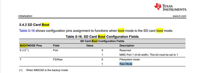

the latest version of mkfs.vfat in dosfstools 4.2 has an issue where it incorrectly calculates the number of sectors (value at 0x20 in the FAT filesystem header) https://github.com/dosfstools/dosfstools/issues/165
This seems to affect AM33 and AM62 ability to corretly read the bootloader files from the FAT filesystem for SD card boot. Two questions:
1. Is it possible to use ext formatted filesystem instead of FAT32?
2. On AM33 I was writing the booloader to the sectors before the first partition like so. Is it possible to do something similar for AM62?  It appears they are written to raw offsets in a 'boot0' partition area for eMMC.

  • Hi Thomas,
    AM62 support SD-card boot in raw-mode. The ROM tries to boot the image from RAW OFFSET of 0x0.
    Usually incase of AM62 for SD-card boot we have use create-sdcard.sh script. which create FAT type boot partition and write  tiboot3.bin, tispl.bin, and u-boot.img images into boot partition.
    Dilna K

  • Hi Thomas,
    Sorry for the delay in response. I was out of office.
    I had a further discussion with our MMC/SD expert they had an opinion that, The partition table is stored at 0x0 offset which conflicts with the tiboot3.bin offset so RAW boot is not practical for SD card.
    In case of eMMC, we have dedicated RAW boot partitions. So, the U-Boot images are flashed here and the Linux filesystem is stored in the different hardware partition. So, it's possible.
    Dilna K
