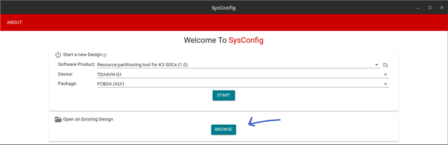

    The K3 Resource Partitioning tool is a SysConfig based tool used to allocate specific system level resources to the various cores of the TDA4 multi-core SoCs. The main and most common use case is partitioning resources such as DMA channels, NAVSS rings, proxies, interrupts, and more. You can find all details on getting started, setting up, and more documentation within the Linux SDK docs. Please follow the 'Getting Started' instructions from the Linux SDK docs FIRST before continuing. Another option is to use the online SysConfig tool with the following configuration for 'Resource partitioning tool for Multi-Core SoCs (1.0.0)' and your device:
    Image 1: Online SysConfig tool
    The K3 Resource Partitioning tool is a way to manipulate the default resource allocations.  Within the RTOS PDK, the standard board config that is packaged and compiled by default is found at [RTOS_SDK_PATH]/PDK/packages/ti/drv/sciclient/soc/V6/sciclient_defaultBoardcfg_rm.c. This file demonstrates the default resources allocated within the standard SDK and can be manipulated and customized to fit your application or use case. You can utilize this as the starting point by selecting the 'Latest Baseline Design' from Image 1 if you are using the online SysConfig tool. The steps are very similar if you are using the SysConfig tool locally with Linux SDK 11.1+. However, if you are using Linux SDK 11.0 or before, you will have to load the baseline default config by selecting 'Browse' as shown in Image 2 and navigating to [LINUX_INSTALL_PATH]/board_support/k3-respart-tool/out/[DEVICE].syscfg. You can also start from scratch, however, we do not recommend this.
    Image 2: Browse to load baseline default config, for ex. ti-processor-sdk-linux-adas-j784s4-evm-11_01_00_03/board-support/k3-respart-tool/out/j784s4-evm.syscfg
