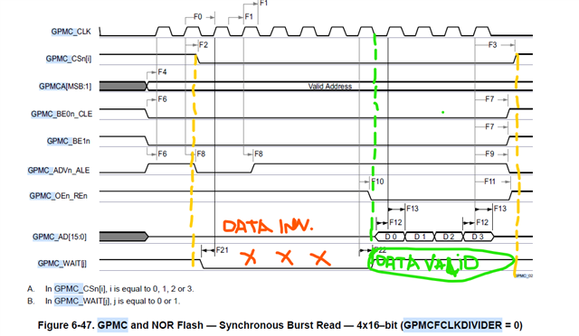

    Q1: Do I understand you correct that during the 1 x 32-bit access and during the two consecutive 16-bit single read  accesses (in your ISR) the WAIT0 signal is constantly kept asserted (active-low) by the ASIC while the CS0 is hold active low by the AM62 ?
    According to the Section External Signals / Subsection WAIT Pin Monitoring Control of the AM62x TRM , the GPMC WAIT signal shall be de-asserted for the GPMC controller to be able to capture a valid data during a data transfer stage. CS0 of course remains asserted during the entire data transfer.
    I have presented the two data transfer phases on the below diagram: GPMC and NOR Flash — Synchronous Burst Read — 4x16–bit (GPMCFCLKDIVIDER = 0) from the Section,GPMC   and NOR Flash — Synchronous Mode of the AM62x Datasheet
    Q2: Is there some chance that your AM62SK software disables WAIT0 pin monitoring at run-time, so it is disregarded ?
    Q3: Have you appropriately configured the SoC wait0 pin polarity (according the ASIC active wait level) ?
    If WAIT is the issue, then we see same issue on U32 reads.
    I think these are not identical usecases - for U32 reads you have a burst of 2 x 16-bit halfwords without intermediate deactivation of the Wait signal (HIGH) during the "valid data transfer stage" (so if this is the case this is normal to expect). For two consecutive 16-bit reads you will have two separate transactions of read data. There should be a de-assertion of the Wait signal not only between the two entire 16-bit transfers but also during the data stage of each of the transfers.

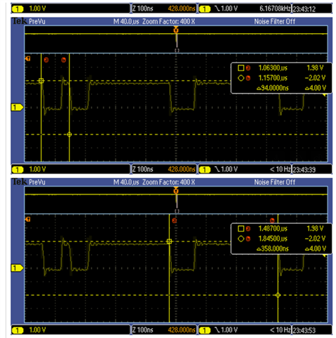

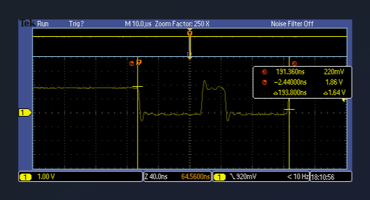

    The GPMC controller controls the CS.  For the U32 read, it asserts the CS twice as shown in the scope capture below.  Since the CS deasserts between the two U16 reads, the WAIT signal would have also deasserted when CS is not asserted. Our  ASIC does not know if it is a U32 read or a single U16 read since all of the control signals from the GPMC are the same.  Note the dead time between the two CS is 40ns.  Which is what we expected.  This read was generated using a devmem command on the debug console.
    This second scope capture is a U32 write and two U16 reads.  The U32 write works just fine, same as U32 read.  However, note the dead time after the write and between the two U16 reads.  The data transfers were generated by CPU running debug code.  I have not reviewed the code but I have to assume it is written in "C" and while probably not the most efficient, it can't possibly be the cause of the excessive dead time.
    Victor
