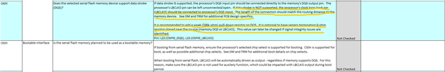

My customer will try to use QSPI boot (Not OSPI).
To confirm correct schematic, I'm checking schematic checklist tool as shown below.
https://www.ti.com/jp/lit/an/sprad91b/sprad91b.pdf
When I check spread sheet, there is following description.
According to this, when user use serial flash for boot, it seems that LBCLKO will be automatically driven as output.
This is defined in "OSPI" column, but is it applied to QSPI as well ?
What kind of output signal is observed on LBCLKO during booting ?

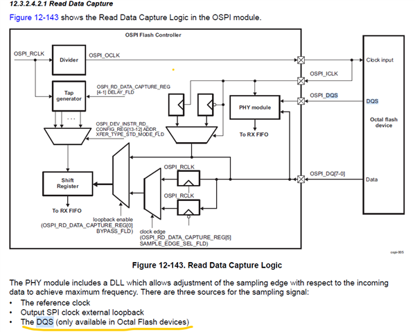

    The section 12.3.2.4.1 Read Data Capture of the AM67A TRM specifies that the DQS pin is not available at the QSPI memory side.

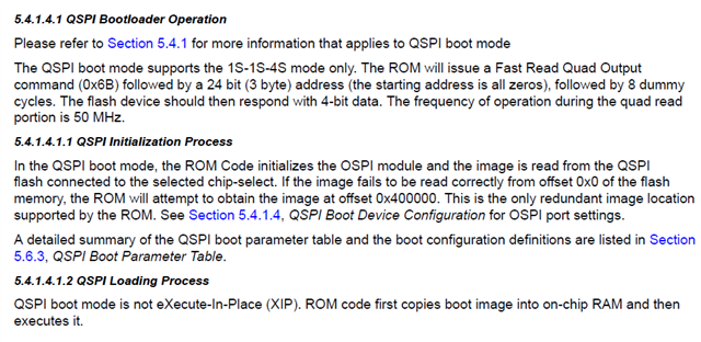

    For the details of QSPI specific booting, please refer to the section QSPI Boot of the AM67A TRM.
    The section QSPI Bootloader Operation of the AM67A TRM specifies that the quad read speed is 50 MHz. From these sections I understand that TAP (No-PHY) SDR mode is supported by the AM67A RBL QSPI Bootloader.

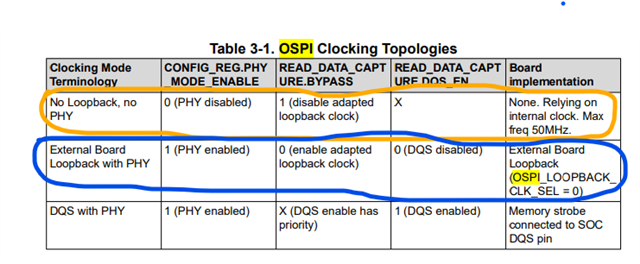

    The description of issue i2249 OSPI: Internal PHY Loopback and Internal Pad Loopback clocking modes with DDR timing inoperable .... of the AM67A Silicon Revision 1.0 Errata provides useful info on the working OSPI clock configurations.

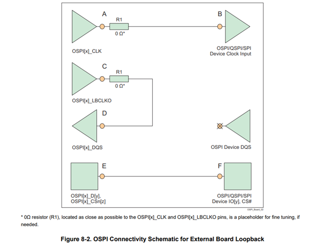

    The table under this i2249 note, lists the supported OSPI clocking topologies. For the QSPI flash memory which does not support DQS signal, only the highlighted options shall be valid. The TAP (No-PHY) DDR mode option highlighted in orange shall be valid when the AM67A ROM performs booting from the QSPI memory. The External Board Loopback with PHY topology is used to allow faster operations of QSPI  (custom bootloader or other operations with Flash memory).
    The two connectivity corresponding configurations are illustrated in the Section,  No Loopback, Internal PHY Loopback, and Internal Pad Loopback and Section, External Board Loopback of the Device Datasheet
    As I refer to the schematic checklist tool from the: https://www.ti.com/jp/lit/an/sprad91b/sprad91b.pdf that you pointed, there is also another note which specifies the connectivity in case that data strobe output (DQS) not available from memory side. Please refer to the guidelines highlighted in yellow. According to the guideline the LBCLKO output shall be connected to the DQS input.
     I hope these findings answer your questions.
    Kind Regards
    Anastas Yordanov
    Thank you for your reply.
    What I would like you to confirm is whether above content should be applied to QSPI as well.
    Is my understanding that user should follow above content to case of QSPI correct ?

  • Hello Ryuuichi Machida-san,
    I would like to apologize for the delay in my response !
    I got confirmation from the OSPI/QSPI expert:
    Even in the case when DQS output does not exist on the serial flash memory side, as its the case with the QSPI memory, looping back OSPI_LBCLK0 to OSPI_DQS at the AM67A SoC side helps close timing on higher speeds. Therefore it is recommended that the SoC OSPI_LBCLKO pin is connected  to the OSPI_DQS pin of the SoC for QSPI serial flash memories as well.
    Make sure that the hardware connection OSPI_LBCLKO to OSPI_DQS at the AM67A SoC side follows the specific PCB trace + pull-down resistor requirement as per the AM6x_TDA4x_DRA8x_SchemCheckList_Tool_v2.02.0.xlsm and also the guidance provided in the the Subsection, External Board Loopback of the Section, OSPI/QSPI/SPI Board Design and Layout Guidelines of the AM62A7 Datasheet. I had confirmation from the expert that the connectivity diagrams and layout / signal integrity guidance in the section OSPI/QSPI/SPI Board Design and Layout Guidelines of the AM67A DS are valid for the QSPI flash memories too.
    => Currently, customer do NOT connect LBCLKO to DQS. According to description of "looping back OSPI_LBCLK0 to OSPI_DQS at the AM67A SoC side helps close timing on higher speeds.",  it seems that connection between LBCLKO and DQS when user use QSPI is NOT mandatory.
    Is my understanding correct ?
    Additionally, I would like to confirm about below.
    Could you please give your comment about below as well ?
    * As I described previous thread, I understand that "OSPI_LBCLK0" and "OSPI_DQS" are NOT active when user use QSPI boot.
    So, I'm not sure why connection between LBCLK0 and DQS will help timing.
    If possible, could you please show the reason about above ?

    Please consider that OSPI_CLK with frequency <=20 MHz is NOT supported by the AM67A ROM bootloader when booting from a QSPI memory. Also xSPI mode will be unsupported by the AM67A ROM bootloader.
    These are covered in the Section, Initialization / Subsection, QSPI Boot of the AM67A TRM
    Please consider the above restrictions if the customer would like to have option for AM67A ROM booting from the QSPI NOR Flash.
    And I have sent a query to the ROM Bootloader team to check if 50 MHz booting is supported without an external Board loopback connectivity between the OSPI0_LOOPBACK pin and the OSPI0_DQS pin.
    I would also request confirmation if the QSPI controller will be able to support:
    A/ transfers that feature <=20MHz
    B/ QSPI memory XIP mode with frequency <= 20MHz
    without OSPI0_LOOPBACK pin connectivity to the OSPI0_DQS pin.

    For now I have a confirmation by the TI AM67A ROM team that the ROM bootloader will set the OSPI controller in TAP SDR mode (using 50MHz OSPI_CLK to the QSPI memory) when booting from the customer QSPI Flash memory. With Tap mode there is no need of a loopback, and this has been validated without connection from LBCLKO to DQS pin. The OSPI internal reference clock RCLK will be set to 200 MHz by the ROM, to derive 200/4 = 50 MHz.  As we already know from the TRM, the ROM QSPI boot is not a XIP boot.
    I am still expecting AM67A team feedback to confirm on the <=20 MHz, no loopback, QSPI memory boot and other usage scenarios !
    Kind Regards
    Anastas Yordanov
    I just had the internal confirmation  from the AM67A experts - there should be no issue with customer QSPI NOR flash when AM67A OSPI configured to operate in TAP mode @ OSPI_CLK freq. < 20MHz. They can therefore  have the LBCLKO and DQS pins disconnected from each other and  each re-assigned to an UART function.
    OSPI PHY mode is designed for higher frequencies and does not make much sense for a < 20 MHz application.
    "=> They will plan to set 20Mhz as QSPI clock."
    I think that a frequency of exactly 20 MHz can not be obtained at the AM67A OSPI0_CLK output.
    Can you ask the customer share a clock tree how exactly 20 MHz are derived at the OSPI_CLK output ?
    I would recommend that customer validates the solution on their prototype PCB (making sure to have followed the OSPI layout guidelines) before freezing the layout.
