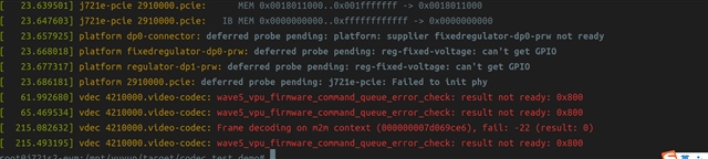

Hi experts:
                our project now needs to develop codec functions, and we are using TDA4VE SDK version sdk1106. Regarding the codec function, we found a problem when testing on our own board. Please check the log and help solve and analyze the problem. Thank you.
                v4l2-compliance related information

                There was a problem running the demo code
root@imotion:/opt/vision_apps# ./run_app_multi_cam_codec.sh

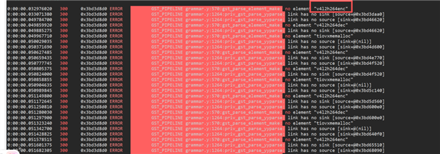

    58.645916 s:  VX_ZONE_ERROR: [ownReleaseReferenceInt:803] Invalid reference

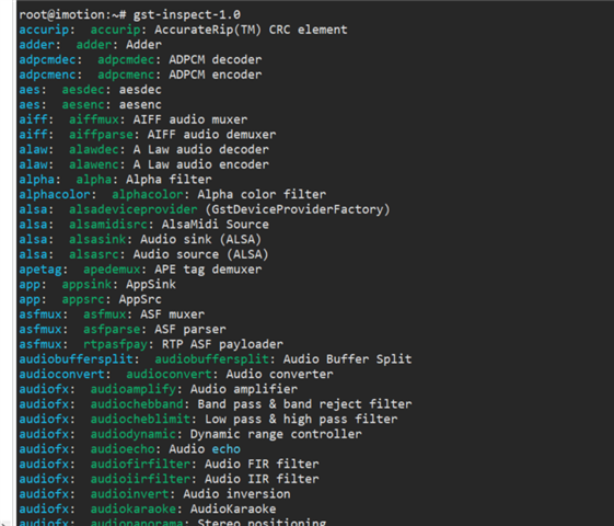

gst_wrapper: GstCmdString:
appsrc format=GST_FORMAT_TIME is-live=true do-timestamp=true block=false name=myAppSrc0 ! queue
! video/x-raw, width=(int)1920, height=(int)1080, framerate=(fraction)30/1, format=(string)NV12, interlace-mode=(string)progressive, colorimetry=(string)bt601
! v4l2h264enc extra-controls="controls, frame_level_rate_control_enable=1, video_bitrate=10000000"
! h264parse
! v4l2h264dec capture-io-mode=dmabuf-import
! video/x-raw, format=(string)NV12, stride-x-align=64
! tiovxmemalloc pool-size=15
! appsink name=myAppSink0 drop=true wait-on-eos=false max-buffers=4
appsrc format=GST_FORMAT_TIME is-live=true do-timestamp=true block=false name=myAppSrc1 ! queue
! h264parse
! appsink name=myAppSink1 drop=true wait-on-eos=false max-buffers=4
appsrc format=GST_FORMAT_TIME is-live=true do-timestamp=true block=false name=myAppSrc2 ! queue
! h264parse
! appsink name=myAppSink2 drop=true wait-on-eos=false max-buffers=4
appsrc format=GST_FORMAT_TIME is-live=true do-timestamp=true block=false name=myAppSrc3 ! queue
! h264parse
! appsink name=myAppSink3 drop=true wait-on-eos=false max-buffers=4
(vx_app_multi_cam_codec.out:304): GStreamer-WARNING **: 15:14:20.540: External plugin loader failed. This most likely means that the plugin loader helper binary was not found or could not be run. You might need to set the GST_PLUGIN_SCANNER environment variable if your setup is unusual. This should normally not be required though.
(vx_app_multi_cam_codec.out:304): GStreamer-WARNING **: 15:14:20.542: Failed to load plugin '/usr/lib/gstreamer-1.0/libgstlibcamera.so': libcamera.so.0.4: cannot open shared object file: No such file or directory
(vx_app_multi_cam_codec.out:304): GStreamer-WARNING **: 15:14:20.543: Failed to load plugin '/usr/lib/gstreamer-1.0/libgsty4menc.so': libgstvideo-1.0.so.0: cannot open shared object file: No such file or directory
(vx_app_multi_cam_codec.out:304): GStreamer-WARNING **: 15:14:20.544: Failed to load plugin '/usr/lib/gstreamer-1.0/libgstcairo.so': libgstvideo-1.0.so.0: cannot open shared object file: No such file or directory
(vx_app_multi_cam_codec.out:304): GStreamer-WARNING **: 15:14:20.545: Failed to load plugin '/usr/lib/gstreamer-1.0/libgstalaw.so': libgstaudio-1.0.so.0: cannot open shared object file: No such file or directory
(vx_app_multi_cam_codec.out:304): GStreamer-WARNING **: 15:14:20.546: Failed to load plugin '/usr/lib/gstreamer-1.0/libgstadder.so': libgstaudio-1.0.so.0: cannot open shared object file: No such file or directory
(vx_app_multi_cam_codec.out:304): GStreamer-WARNING **: 15:14:20.548: Failed to load plugin '/usr/lib/gstreamer-1.0/libgstpnm.so': libgstvideo-1.0.so.0: cannot open shared object file: No such file or directory
(vx_app_multi_cam_codec.out:304): GStreamer-WARNING **: 15:14:20.551: Failed to load plugin '/usr/lib/gstreamer-1.0/libgstcompositor.so': libgstvideo-1.0.so.0: cannot open shared object file: No such file or directory
(vx_app_multi_cam_codec.out:304): GStreamer-WARNING **: 15:14:20.552: Failed to load plugin '/usr/lib/gstreamer-1.0/libgsttiovx.so': libgsttiovx-1.0.so.1: cannot open shared object file: No such file or directory

    I have a couple of initial questions:
    1. Is this at all reproducible on our EVM at all? Could you please try it and let me know.
    2. Which fusion board are you using?
    3. Do any GStreamer pipelines work?
    Sarabesh S.
  • Hi :
                      I don't have the right camera, so I haven't tested your EVM board.We use our own board and have tailored the file system.
                      Many plugins for gstreamer are OK, but there is no v4l2h264enc plugin. Where can I get it? Or can you provide it?
  • This should be enabled default in the SDK. What kernel version are you using?
  • Hi :
                       The kernel has also been trimmed to some extent. lsmod is as follows, and the corresponding modules are all open, The corresponding modules are all open. Can you see any problems?
                       Is the v4l2h264enc plugin related to the kernel or /usr/lib/gstreamer-1.0?
  • Hi Gaston,
    Could you clarify that you are using the upstream version of the driver? If so, I'd like to see what the delta is from our current SDK releases to see if there are any bug fixes you may not see. I am also not sure what all was trimmed from your kernel tree. Could you let me know what cat /proc/version is showing?
    Since we don't have your setup, could you try running a simple Gstreamer command to see if basic Gstreamer functionality is there:
     gst-launch-1.0 videotestsrc pattern=ball num-buffers=700 ! video/x-raw, format=NV12, width=1920, height=1080, framerate=30/1 ! v4l2h264enc ! h264parse ! filesink location=/root/pattern-ball-demo.h264
    Yes, the v4l2h264enc plugin is the userspace piece to interface with the V4L2 M2M kernel driver underneath. Both the kernel driver and the userspace plugin are needed to execute on the hardware.
    Thank you,
    Sarabesh S.
  • Hi h :
                      The gst-launch-1.0 you mentioned above can work. We have solved it. Now we have encountered an error problem. The encoding function is basically ok, but the decoding function cannot run. There is the following error. What is the cause of this problem? Is it a driver problem or an application problem? How to troubleshoot and solve it?
  • Hello Gaston,
    Please share with us an encoded stream and your decoding command that can help us reproduce this decode issue.
    Adam
  • Hi Adam:
                  This is a post from another colleague of ours, which contains relevant information
                  e2e.ti.com/.../tda4ven-q1-v4l2-driver-encoding-without-p-frames
  • Glad that your encoding issue is resolved. Can I see what pipeline or application you are running in user-space to decode the input stream? This way I can attempt to replicate the issue on my machine.
    Thank you,
    Sarabesh S.
