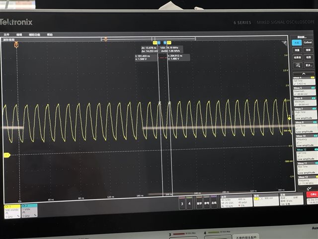

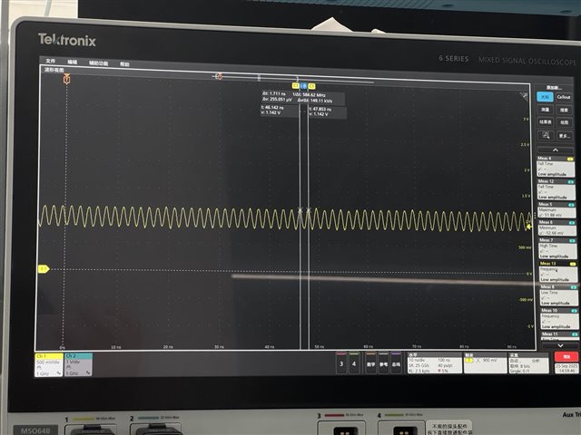

However, when switching to DPI1, I found that the PCLK waveform of Vout1 was very strange. The waveform diagram is shown below.
When I switch back to DPI0 again, I find that the PCLK waveform for Vout0 looks pretty good.The waveform diagram is shown below.
Could you please help me confirm if there were any omissions in my modifications that caused PCLK anomaly?
