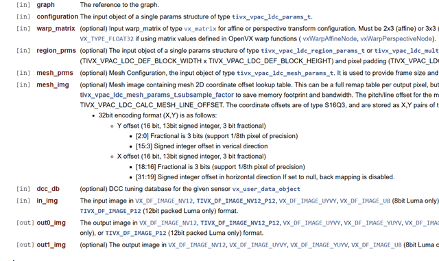

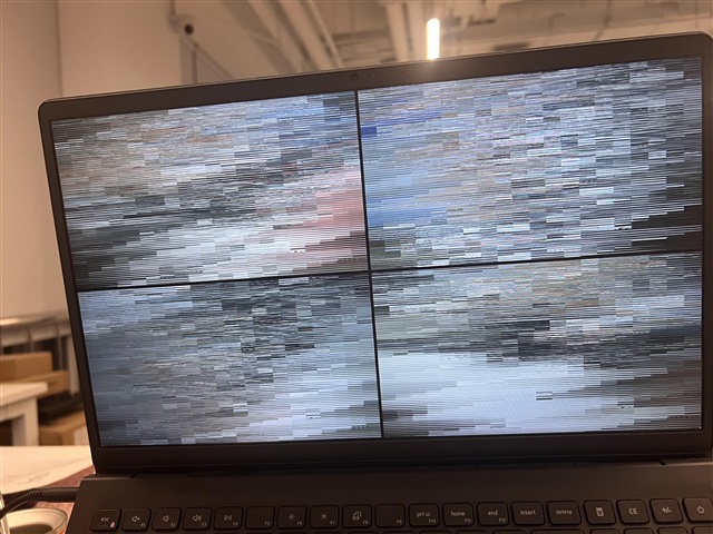

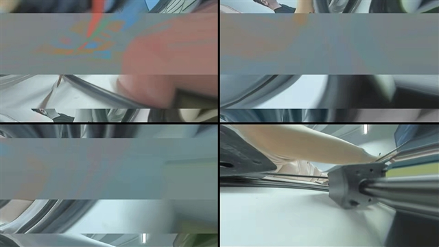

I encountered some issues while using the LDC kernel on the entry J722s SDK11 platform. The specific details are as follows: I used the capture output (1280*960) with 4 channels as input for LDC. When using the native code with #define LDC_TABLE_WIDTH (1920) and #define LDC_TABLE_HEIGHT (1080), three of the image channels exhibited a blurred section in the middle, while one channel remained normal. However, when using #define LDC_TABLE_WIDTH (1280) and #define LDC_TABLE_HEIGHT (1960), all four output images appeared blurry. Below, I will attach screenshots of the output images for both configurations. The following code snippet shows a simple initialization I performed for LDC:
c
static void set_ldc_default_params(AppObj *obj, LDCObj *ldcObj)
        ldcObj->info_Input.width = 1280; //INPUT_CAMERA_WIDTH;
        ldcObj->info_Input.height = 960; //INPUT_CAMERA_HEIGHT;
        ldcObj->info_Input.dataFormat = VX_DF_IMAGE_UYVY;
        ldcObj->info_output.width = 1280; //INPUT_CAMERA_WIDTH;
        ldcObj->info_output.height = 960; //INPUT_CAMERA_HEIGHT;
        ldcObj->info_output.dataFormat = VX_DF_IMAGE_NV12;
Below, I will provide the code for app_ldc.c and app_ldc.h. Could you help identify which configurations might be causing this issue?
