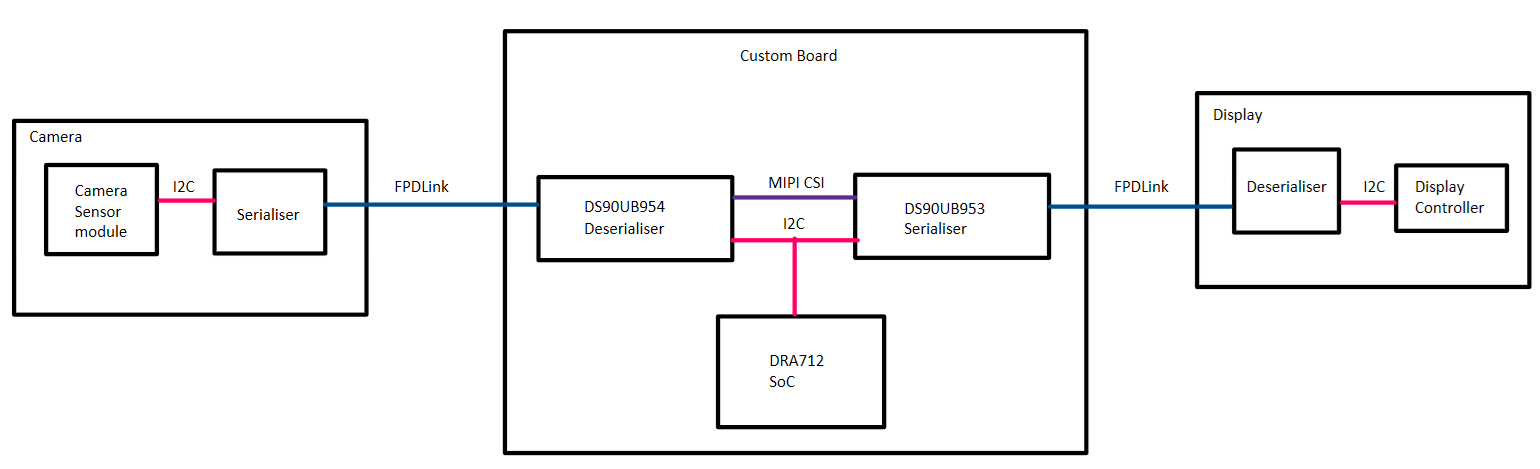

We are facing DRA712 I2C bus stuck and I2C controller timed out on our DRA712 based custom board.
The system is running yocto/linux. Kernel version 4.19.73.
Linux Kernel log = "omap_i2c 48070000.i2c: controller timed out"
As shown in the partial block diagram above, the other 2 chips connected on the same I2C bus are TI's DS90UB954 and DS90UB953, which are FPDLink-MIPI_CSI SerDeses.
During normal operation, there is some periodic I2C traffic between the two SerDeses every 20ms.
The SoC I2C controller timeout is seen when the SoC tries to access the DS90UB954. Its just a single byte write operation. The issue occurs around 2% of the times SoC accesses the bus.
Using protocol analyzer, we found that during the issue, the I2C bus was stuck for around 1 second.
This stalls the periodic I2C communication between the two SerDeses causing issues in the overall system.

  • Hello Anand,
    Does this only happen in the bus that is connected to the FPD-link devices?
    Can this be recreated with a TI evm standalone?
    Secondly, can you elaborate what the cause for the 2% occurrence is?
    Ergo, is it a specific register or specific byte?
    For the third question.. In my opinion, you wouldn't want to change this for the i2c-omap driver because this would affect all i2c transactions in the system and I do not know whether this would cause other issues. Ill keep looking at this issue to see what the best recommendation could be based on the understanding of why this happens.

  • Hi Josue,
    Thanks for the reply.
    Please find the answers inline.
    • Yes
    • We haven't tried.
    • It doesn’t look byte/register specific as for the other 98% time also we were doing the same transactions repeatedly.
    Also, for the OMAP_I2C_TIMEOUT reduction approach, need to understand if this is safe to do from the protocol/controller perspective.
    If need arises, how much we can reduce it to?

  • Anand,
    I believe there is ways to reduce the I2C timeout for one device via ioctls, for the driver, I am not sure at what the repercussions are to reduce the timeout from the controller perspective. I will have to look into it and respond by the end of the week.
    -Josue
  • Anand,
    This timeout is usually chosen to be a stable timeout for a myriad of connections/devices. From the controller perspective I believe it is safe but system-wise you have to be aware that  any changes will affect the reliability of other devices connected on I2C. This will require you to do some system validation.
    Have the SDA and SCL lines been inspected using a scope?
    Could you attach a screenshot of the decoded transactions at the failure?
    -Josue
