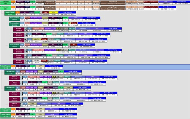

When a customer uses an AM3354 and a PL2586 USB hub downstream for ESD testing,
the data is recorded to the USB hub and an ERR message is displayed. This error message is normal, but the CPU USB host controller cannot detect the error, and the CPU cannot recover from the hub.

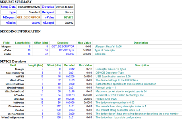

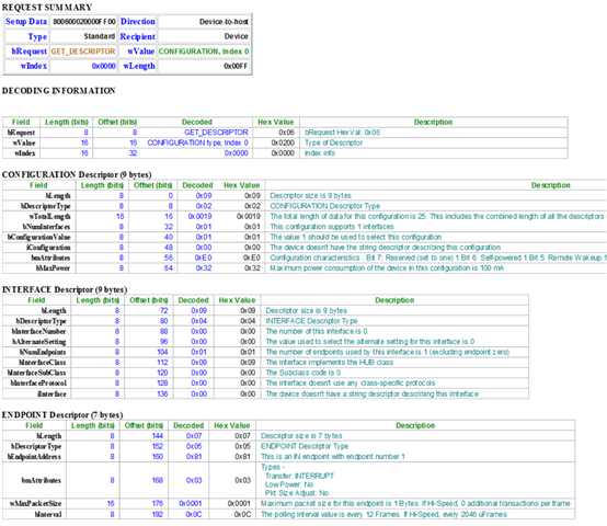

  • Hi Daniel,
    Can you confirm this USB hub is not problematic and is able to provide a valid descriptor when connected to a PC?
    Luis Parga
  • Yes, This usb hub can perform valid enumeration with both PC and AM3354.

  • Hi Andy,
    When you say 'the CPU cannot recover from the hub', do you mean the AM3354 USB 2.0 controller stops working after the USB2.0 analyzer connected to the USB hub observes the 0x3C error? Does this happen during IEC61000-4-2 testing? Do you have ESD diode protection for D+/D- and VBUS lines on the AM3354? Do you see ESD issues when conducting the test without the USB hub in the loop?
    Luis Parga
  • Hello Luis,
    When ESD happens, the device (mouse in this case) ,which connected to the hub, stop working.
    And hub will report the 0x3C error to AM3354.
    Our problem is that the AM3354 usb host controller can not detect this error.
    We need TI help to find a way for AM3354 to detect this error.

    2. in this case, we are not using thumb-drive. Because this particular hub port is
        for mouse / keyboard usage.
    3. since this is an INT-IN endpoint, and hub is reporting error (0x3C), we expect
        hid driver can detect this error USB_EVENT_ERROR
    Thanks a lot
    Hairuo

  • Hi Hairuo,
    After checking internally, the team believes this is software issue where the AM3354 USB host software is not handling the ERR transaction from the hub properly. Can you provide more details on the software implementation the customer is using? Why is SDK not being used? Could customer migrate to using the SDK (maybe Linux) so we can better support them? I see latest version as of end of last year in ti.com.
