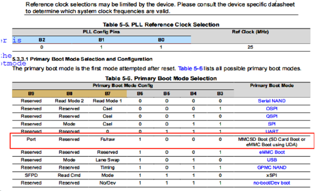

1:Bit9/8/7=001 ,Bit6/5/4/3=1000,Primary startup mode  is Emmc ;
2:Bit9=1,Bit9/8/7=101,Primary startup mode  is SD card, Set the device to this mode.,Once the SD card is inserted, the device will boot and operate normally.
However, when the primary boot mode is set to EMMC and the secondary boot mode is set to SD card((Bit13/12/11/10=1101)), and the EMMC is empty, the device should theoretically switch to the secondary boot mode. However, it fails to start normally. What could be the reason?

    BOOTMODE[15:0]=34C3 => eMMC UDA/raw (primary) SD(backup)
    I reproduced the auto-switching issue from empty eMMC to SD on TI EVM. Can you try the attached u-boot BL1 patch on your setup?

  • Hi Hong!
    Bit 7=1, use RAW mode,  Does the mentioned PATH also apply?
  • SD(BACKUP) use RAW mode,is it also effective?
  • The backup boot mode is determined from BOOTMODE[13:10], & BOOTMODE[13:10]=x101 => eMMC or SD, where only eMMC UDA/FS or SD/FS is supported as noted in AM62L TRM
    - BOOTMODE[13]=0 => eMMC
    - BOOTMODE[13]=1 => SD
    <5.4.2.1 SD Card Bootloader Operation> in AM62L TRM.
    "...When SD Card boot is used as a backup boot option, only User Data Area (UDA) in filesystem mode is
    supported. Raw mode is not supported...."
