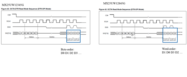

A TI representative indicated the TI AM62 Family of processors are enabled to complete OPI Mode(x8 SPI) read and OPI Mode(x8 SPI) write accesses to the  MX25UW12345G (Byte Mode) & MX25UW128(Word Mode) Octa-NOR Flash parts.
Reference the Octa Flash Byte and Word Mode Accesses.png for details on Octa-Flash Byte Mode  and Word Mode outs byte order.
Does the AM62 OSPI controller support byte swapping capability?
