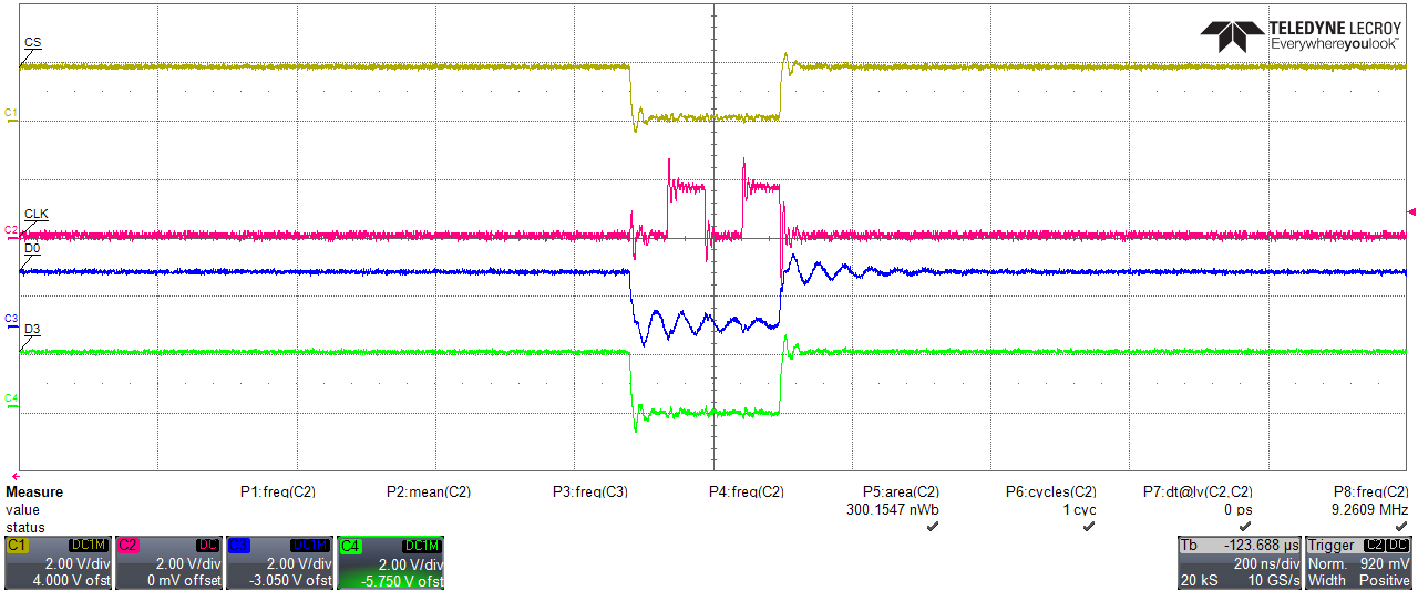

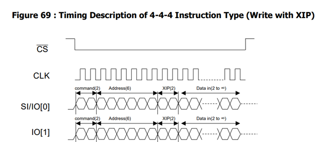

The datasheet of the MRAM we want to use requires that the CS remains asserted throughout a single transaction until it is completed.

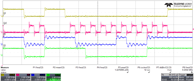

However, the actual waveform output from the custom board is as follows.
- After the command, the CS is turned OFF once.
- After the data transmission, the next command and address are immediately sent out.
- Then no data is sent, there is a waiting period, followed by sending the command again, waiting again, then sending the command, address, and data.
This difference causes problems with writing,
Even though I intended to write zeros to mtd0, 0xa5 is written at every 256-byte boundary.

    By analyzing the data in more detail, it was found that the signals are sent in the following order.
    CMD(WREN)
    CMD(WREN), CMD(WR), ADDR, DATA
    CMD(WREN)
    By enabling WEL_DIS_FLD (8) of the OSPI_FLASH_CFG_DEV_INSTR_WR_CONFIG_REG, it was possible to remove WREN as shown below.

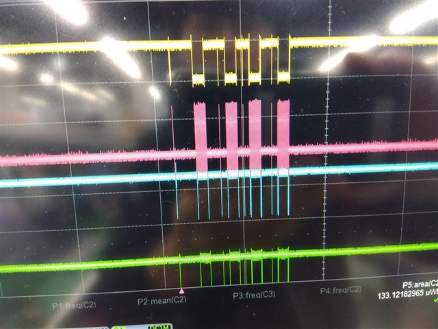

    CMD(WREN)
    CMD(WR), ADDR, DATA
    CMD(WR), ADDR
    CMD(WREN)
    CMD(WR), ADDR, DATA
    CMD(WR), ADDR
    We would like to remove the CMD(WR), ADDR that come after the CMD(WR), ADDR, DATA.

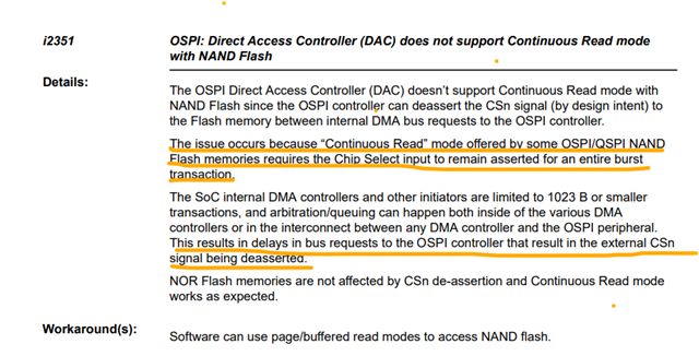

    Regarding de-assertion of the CS line during transactions currently I came across this hint - i2351 description from the AM62Lx Sitara Processors Silicon Errata:
    I'll try to reach out to a TI OSPI Linux software expert regarding your question on the driver modification and command sequence optimization. Please expect that some delay is possible.

  • Hi Anastas Yordanov-san,
    Thank you for the information about the errata.
    Does this erratum indicate that the same phenomenon occurs not only during reading but also during writing?
    Indeed, while it may be undesirable for CSn to be deasserted, the read instruction itself appears to be functioning correctly.
    Therefore, I believe the issue lies with the "write command with no data" issued after the write command.
