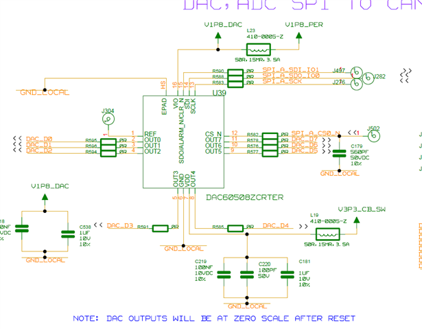

We are using DAC60508ZCRTER chip in one of our projects and it's connected to AM6442 processor. Below is the dts setting for SPI
&main_spi1 {
status = "okay";
pinctrl-names = "default";
pinctrl-0 = <&main_spi1_pins_default>;
cs-gpios = <&main_gpio1 47 GPIO_ACTIVE_LOW>;
ti,pindir-d0-out-d1-in;
spidev0: spidev@0 {
compatible = "lwn,bk4";
reg = <0>; /* Chip select 0 */
spi-max-frequency = <1000000>; /* Adjust as per your device */
#address-cells = <1>;
#size-cells = <0>;
main_spi1_pins_default: main-spi1-default-pins {
pinctrl-single,pins = <
AM64X_IOPAD(0x0224, PIN_INPUT, 0) /* (C14) SPI1_CLK */
/*AM64X_IOPAD(0x021c, PIN_OUTPUT_PULLDOWN, 0) /* (B14) SPI1_CS0 */
AM64X_IOPAD(0x021c, PIN_OUTPUT_PULLDOWN, 7) /* (B14) SPI1_CS0: GPIO1_47 */
AM64X_IOPAD(0x0228, PIN_OUTPUT, 0) /* (B15) SPI1_D0 */
AM64X_IOPAD(0x022c, PIN_INPUT, 0) /* (A15) SPI1_D1 */
with this I am using C application to communicate with the DAC device which i will attach here

Device is running on Linux OS and when device boots I can see /dev/spidev2.0 getting list. Problem is that when the communication starts i cannot see SPI_CS going LOW it stays HIGH always
Could you please tell me what is been missed. Below is the schematic snapshot
Please help us here
