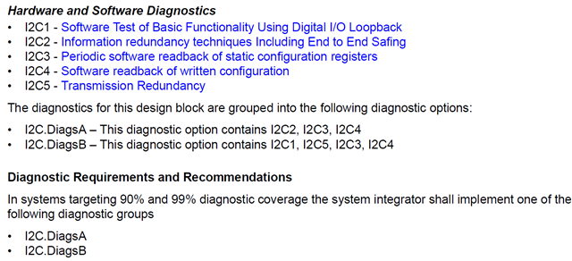

i am working on AM62A7 SITARA SOC  . Regarding the I2C related safety mechanism, i want to understand If we are implementing E2E  safety mechanism for the I2C channel do we still need to implement I2C.DiagsA or I2C.DiagsB for achieving ASIL B metrics .
